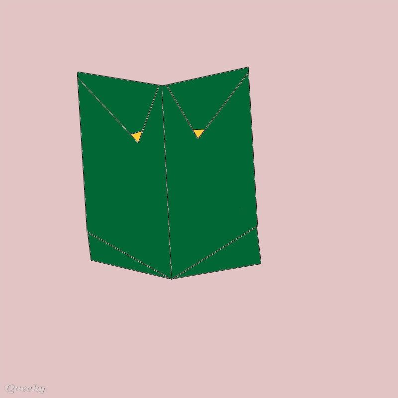

Step 1:
Make a mark 2" from each side at the top of the paper, then make two more marks 1/2" above the bottom edge of the paper on each side.
Make valley folds as shown.
