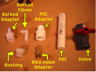

For the Blood Shooter Rig
1. Small tube of quick set epoxy.
2. A length of 1/2" diameter PVC pipe. (3in should do the trick.)
3. Plastic 1/4-turn release valve, with 1/2" female thread on both sides.
4. PVC adapter from 1/2" slip to 1/2" male thread.
5. Nylon bushing from 1/2" thread to 3/8" thread.
6. Brass bicycle valve adapter from 3/8" thread to...uh..bicycle.
7. 5' length of 3/8" inner diameter (ID) flexible hose.
8. Nylon adapter from 3/8" barbed to 1/2" male thread.
9. Nylon 3/8" barbed elbow joint.
10. Tiny rubber bands (found in the hair accessories isle)
11. Plastic wrap.
12. Empty 2-liter soda bottle.

Step 1: The Air Tank
Using some epoxy bond the 1/2 PVC adapter to your PVC pipe then your release valve to the PVC adapter.
Next using a bunch of epoxy bond the other end of your PVC pipe to the end of your empty 2-liter soda bottle. Make sure and use enough epoxy to make this strong and air tight! Also I noticed that different brands of soda have minor differences in the diameter at the top of the bottle. Out of the handful I tried, Pepsi bottles seemed to fit the PVC pipe the most snug.
Congratulations you've just made the heart and soul of your blood shooter! Easy huh?

Now you need to trim one end your elbow joint. I used a rotary tool, but you could use a steak knife or a hack saw in a pinch. It would just take a bit longer. Either way you'll want to cut off all the barbed edges except for the last one. When it's done it should look like the picture below. This is the part of the rig where the blood will shoot out. Therefore we do not want too much of it to stick out.
Next take your 5 feet of clear hose (being clear makes it easier to see how much blood you have in there) and attached your modified elbow to one end and the 1/2" threaded adapter in the other.
Step 3: The Filling Adapter
Take your Nylon bushing and screw in the brass bike valve adapter. Done!
