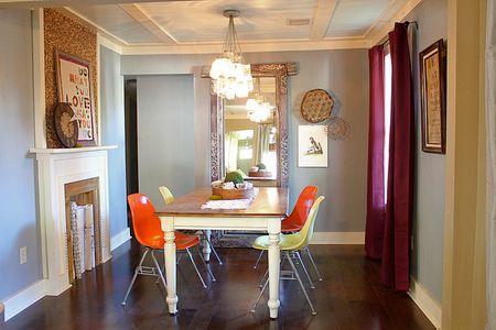

Introduction: How to Make a Chandelier Using Mason Jars
We made this chandelier to be the centerpiece of our dining room. You can check out this DIY and Design projects like this one on our blog, www.KaraPaslayDesigns.blogspot.com.

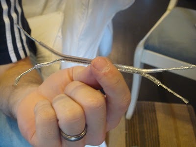

Now we are ready to wire the lit jars. Take one of the four remaining 2' wire sections you have and feel the rubber insulation. One of the wire will have a ridge while the other will be smooth. The "ridged" wire will be connected to the silver screw of your socket and the smooth will attach to the brass screw.
One the stripped end of your wire pull the wires apart about a 1/2" down. (Reference the picture above)
Insert this end of the wire into the steel nipple. Paying attention which wire will go to which screw separate the wires as the exit the nipple.
Loosen the screws and wrap the wire clock wise underneath them. Then tighten them back down. Replace cardboard wrap.

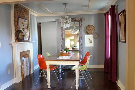

All that is left is to install your new fixture. It is a good idea to have another set of hands during this step to help hold the weight while you make your connections.
Connect your "hot" pigtail to the black wire in the ceiling and the neutral pigtail to the white wire from the ceiling.
I recommend installing the 3" screws (or whatever size you need based on your housing) to your mounting plate and fitting the housing over these. You will need to install the acorn nuts and then keep turning them until they hold PVC housing tight against the ceiling. If you do it this way you need to make sure you insert the machine screws into the threaded holes in the mountain plate.
That's it. I love this unique light fixtures and gotten lots of positive feedback. Hope you enjoy it as much as we do.
