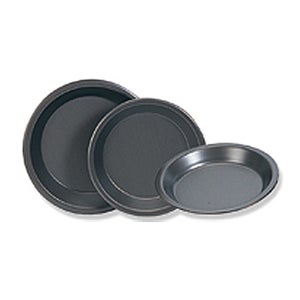

6. Black metal plate/pan

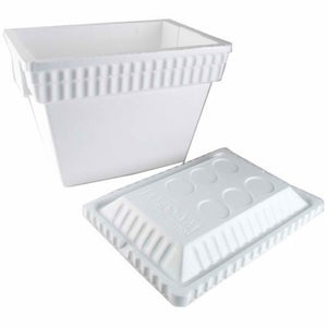

9. Styrofoam cooler lid

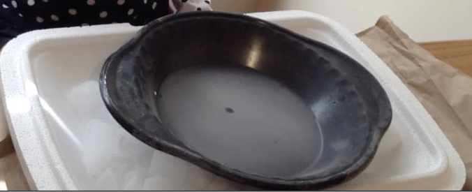

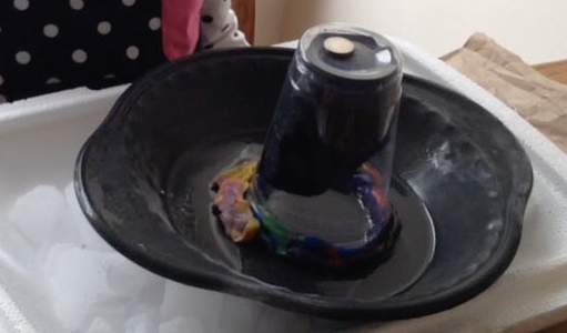

Step 2: Place Metal Plate on the Dryice
- Take the Styrofoam cooler lid and put some dryice (solid CO2) on it.
- Caution: Make sure that you wear insulated gloves when handling dryice (-109.3°F or -78.5°C)
- Now place metal plate on the dryice and wait for few minutes until the surface becomes very cold
Step 3: Put a Piece of Felt Inside the Plastic Cup
Step 4: Put the Magnets Inside and Outside the Cup So the Felt Won't Fall Off

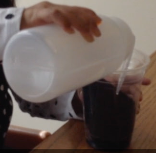

Step 5: Soak the Felt With Isopropyl Alcohol
Pour isopropyl alcohol in the cup, soak the felt well and if extra isopropyl is left in the cup just pour it on the dry-ice.
Caution: Wear safety goggles when you are using isotropy alcohol.

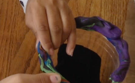

Step 6: Use Play-doh Around the Top Edge of the Cup
To avoid any leakage of the alcohol vapor between the cup and metal plate, use paly-doh.
Step 7: Invert the Plastic Cup on to the Metal Plate
- Invert the plastic cup on the metal plate and press firmly so that plastic cup sticks to the plate.
- If your play-doh becomes too dry after coming in contact with isopropyl alcohol then switch to plasticine.

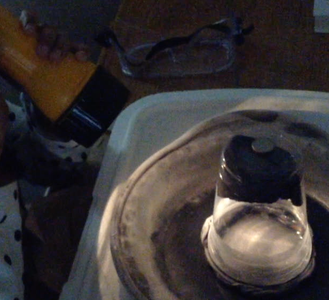

Step 8: Focus Flashlight at the Base of the Cup
- Wait for 2 or 3 minutes and you will see alcohol mist inside the cup due to temperature gradient between the top and the bottom of the plastic cup.
- This implies more alcohol vapor at the top of the cup becomes super cooled by the time it gets to the bottom of the cup where the temperature is too low for the vapor to exist, this is known as super-saturated state.
- When an electrically charged particle zips through the supersaturated alcohol vapor, it will ionize the vapor atoms by ripping off the electrons along its path. This will trigger the condensation process and we can see trail (thread of droplets = cloud) of the charged particle.
- Focus flashlight at the bottom of the cup to see tracks of charged particles which pass through the super saturated alcohol vapor.

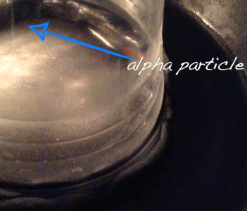

- Thick small tracks are alpha particles (due to radon atoms in the atmosphere, not related to cosmic rays)

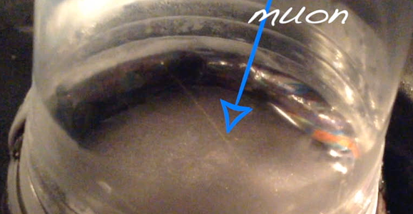

- Thin and long tracks are muons (originating from cosmic rays)
