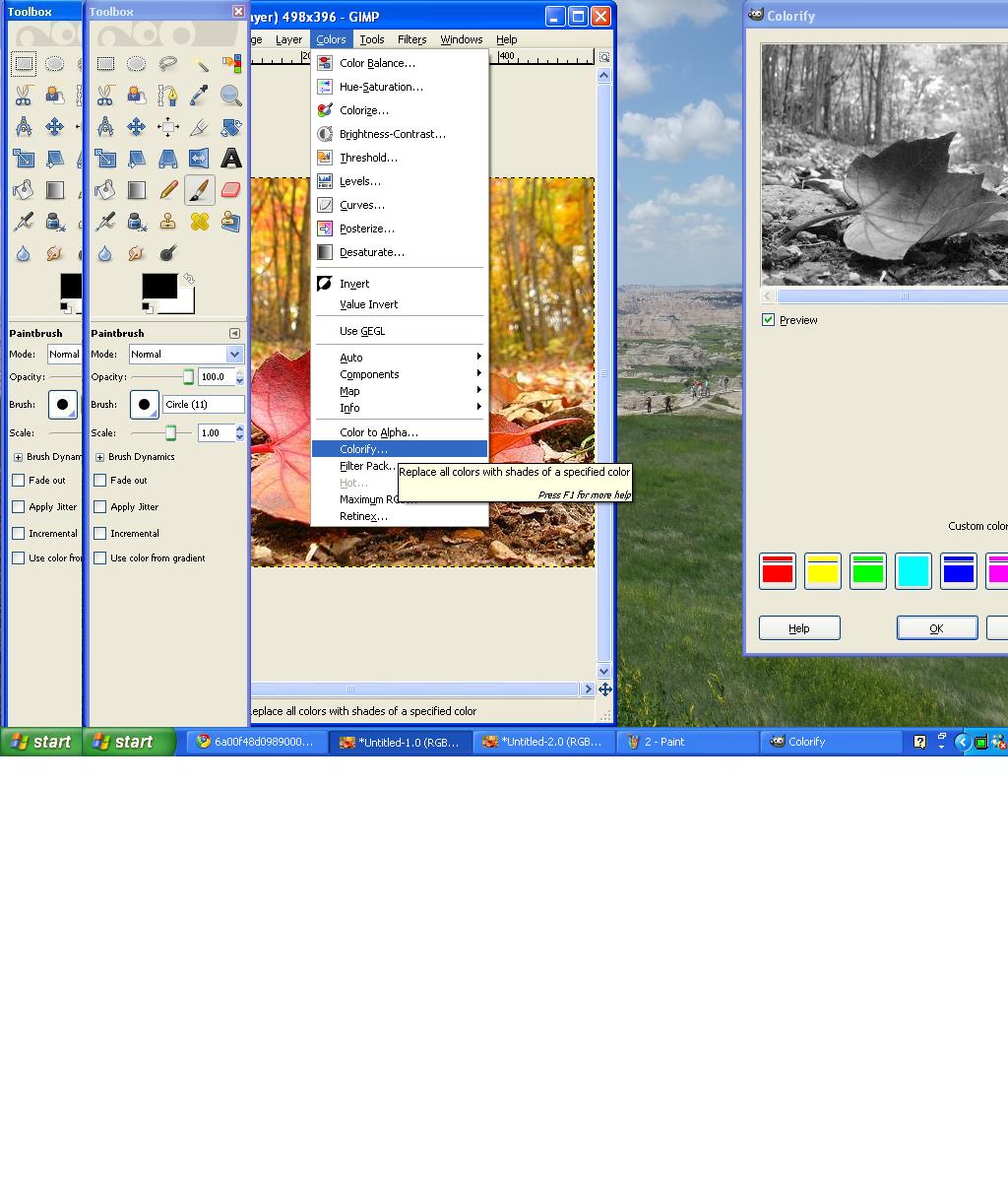

Step 2: Old Fashion
Turn ONE picture into Black & White.
Colors>
Colorify>
Click on White Box>
OK
Colors>
Colorify>
Click on White Box>
OK

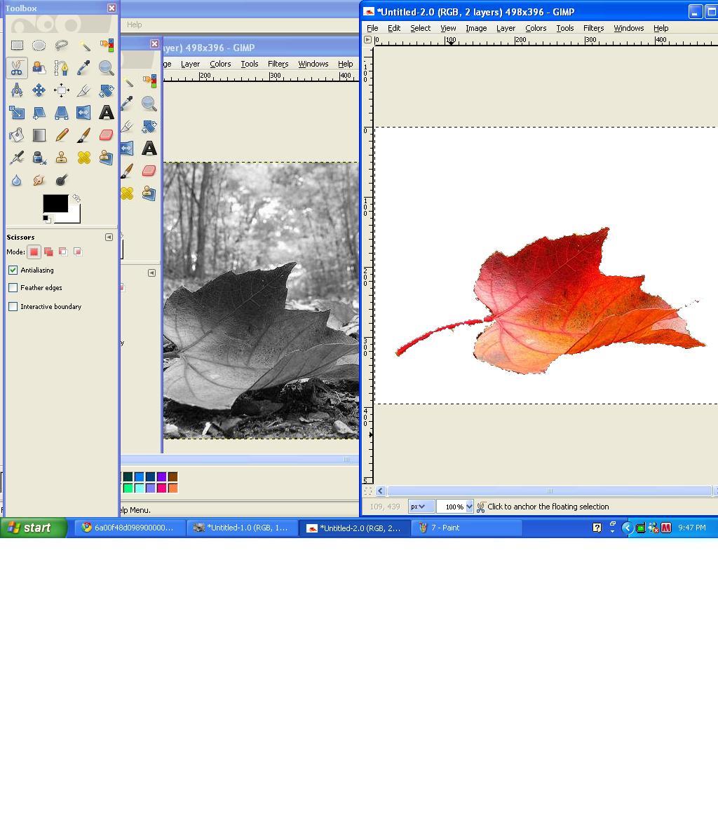

Step 3: Dots
Select the scissor (i don't know what the real name is) tool and click and make dots around the WHOLE picture.
When done, strike the Enter Key on the Keyboard. The "Marching Ants" will appear and your picture will be in white.
Step 4: Copy 'N' Paste
Copy the colorful Image (leaf) by right clicking, Edit Copy. Open the Black and white image and Paste.

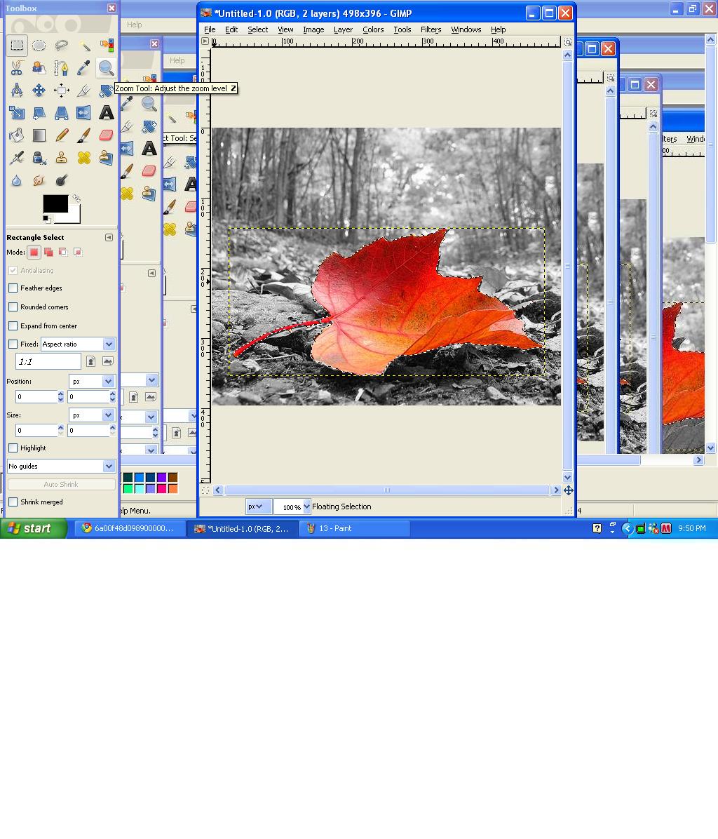

Step 5: Align
Now once you have the colorful picture onto the Black and White picture, select the Rectangle tool. Click on the colorful image (leaf) and drag it over top of the black and white image (leaf).

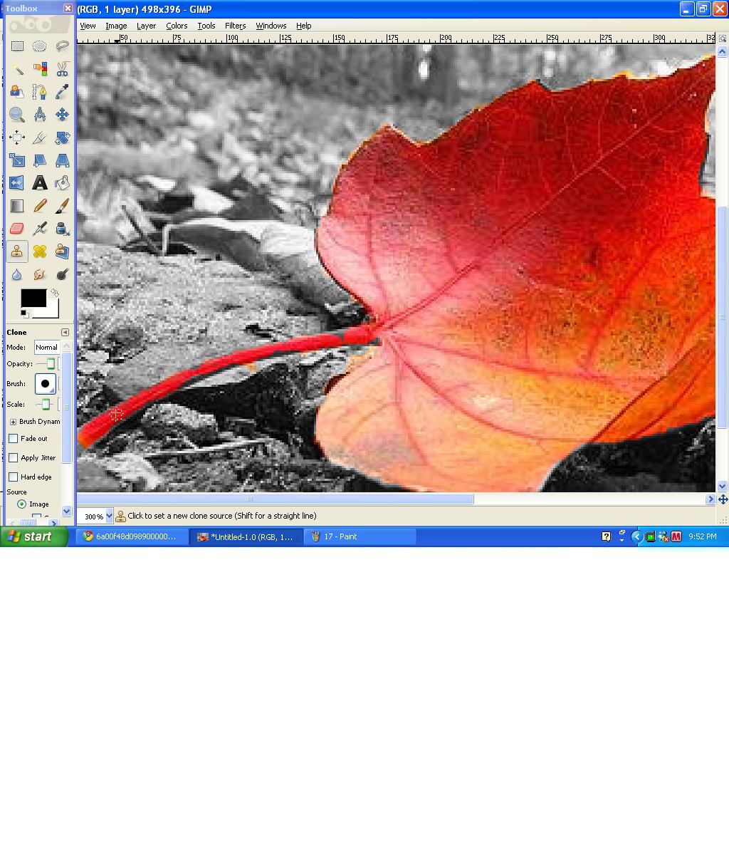

Select the Clone Stamp tool. to sample a spot hold CTRL and click a spot with the same color as the uncolored spot should be (i sample right underneath the bare spots).
use the clone stamp as a paintbrush and apply color to the missing spots. to do so, left click and drag.
Now select the zoom tool and zoom in a place of which you missed.
