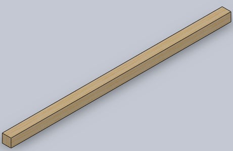

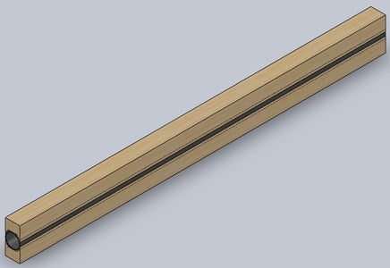

Step 3: The Barrel
First things first, we make the frame with the barrel, this is the part where all the other parts are built around.
The first step is to cut 2 1 meter pieces of the 40mm x 40mm, be sure that the wood is really straight or it will cost performance.
In the next step you will have to make a slot in both 1 meter pieces to accommodate the 40mm PVC, the PVC needs to be roughly 10 to 15mm in the wood, so there is a 10mm gap left for the slot in the side of the PVC. you can make the slot using the plunger router.
Note: if you haven't got a plunger router you can also decide to take a thinner piece of wood for the barrel and gluing strips to that piece of wood to achieve the same result.
After that you can place The wood over the PVC to make the brackets.
Cut the brackets to size and place them over the wood. The brackets are in this configuration 90x100mm out of 9mm plywood.
Drill 4 4mm holes through each set of brackets. secure the brackets by putting M4 threads through the holes and securing them with nuts and washers.
Note: at this point it would be smart to number each bracket to mark it's place on the crossbowgun
The next step is to glue the barrel in place using strong glue. this is done by removing the brackets, separating the barrel and wood, gluing the barrel and wood together using lots of glue and then reattaching the brackets and securing them with the nuts and washers.
Note: it is important to let the glue set properly at this time, you can either wait or make some small separate parts
After the glue has set, use the dremmel to cut the slot in the barrel, do as much of the side as possible before removing the brackets again to prevent the glue getting separated from the barrel. the slot has to be at least 6mm wide for the piston to fit through. After you have made the slot in the ENTIRE barrel, you can move on to the next step.
Note: you have to separate the entire barrel so that it is possible to disassemble the bow in 2 halves and some random parts, else you wont be able to fit the piston and secure the barrel with screws.
With all the brackets removed, it should be possible to reinforce the glue with screws, this is done by:
Separating both halves of the barrel, drilling about 10 holes of 1 to 2mm in each halve, countersinking each of the holes so that there are no screw heads sticking out, jamming the bow, and then securing the barrel to the wood using screws.
Note: when countersinking the barrel, remember: too deep is better than too shallow

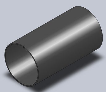

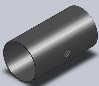

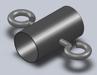

Step 5: The Piston
The piston is the part that pushes the projectiles forward and connects to the rubber bands.
it is made from 32 x 1,6mm PVC with the M6 hooks and the connector nut and a normal nut.
first cut a 6cm piece of the 32mm x 1,6mm PVC. smooth the edges.
Drill a 6mm hole straight through the PVC, be sure it is straight, if it's off you can't use it.
Next cut the M6 hooks to length so that both hooks will stick about 2 to 3 cm out of the PVC.
Lastly put both hooks through the holes and connect them both with the connector nut with a normal nut next to stop it from coming loose.
Note: If you have problems attaching the rubber bands to the hooks, you can slightly bend the hooks so that the gap will be bigger.

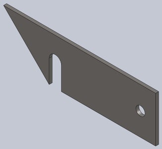

Step 6: The Trigger
the trigger is the most complicated part if you don't have any access to sheet metal and strips of steel.
The idea is to make the trigger look like this, the hooks should be on the width of the center of the piston hooks, all the nuts should be tightened as much as possible for this one part to prevent the separate parts from slipping.
the trigger should be at least 2mm thick, the base plate of the trigger should also be at least 2mm thick.
I used for the thread M6 but you can also use M8 or even M10 if you want to make it stronger.
Apart from that there are no real measurements for the trigger. but just for the idea, my measurements.
