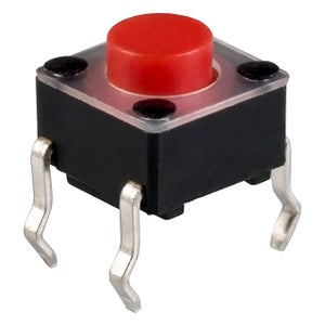

2. A momentary button

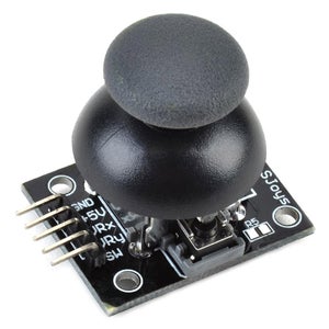

3. An analog thumbstick usable with arduino

First we plug our thumbstick in to the analog ports on the arduino, since a thumbstick consists out of transistors we will recieve analog values. The plug in your push button in a digital port. We will then be able to send these values from arduino to processing via the serial port with the following code.

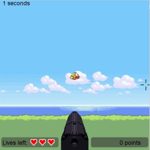

Okay, now its time to write the code for the game:
The game is written in processing, and you will therefore have to download the Processing IDE for it to work.
To make it easy for us we divide the game in to three different classes: Main, Menu, and Game. We write the code this way to make it simpler for us to switch between the menu and the game. And to not terrorize you with a bunch of code; here are links to the different classes.

We used some self made sprites for the game, except for the bird, which is taken from the game "Flappy Bird".
*Copyright infringement not intended, all rights to the rightful owners of Flappy Bird*
