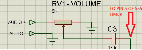

Remembering: You can use IRFP260N or better for more power... I suggest to use in minimum 5A transformer... Transformers is best than switching power supplys for this circuit! You can play audio in arcs adding a audio jack and replacing 100nF capacitor for a 470nF capacitor in pin 5... Like the picture.
