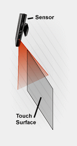

You need to affix the sensor so that it is flat level with the touch surface. If you are projecting onto a wall then the sensor must be mounted flat on the wall. For an LCD display you may need to construct a suitable mount.
The sensor should be mounted near one of the corners and angled to point diagonally to the opposite corner. It should be at least 60cm away from the corner of the picture.
There are several ways to attach it, the simplest is just to stick it to the wall with gaffa tape. If you feel a little more adventurous and are using a projector, then use a Kinect mount like this and fold it together, drill through to screw it to the wall.
It is important that the sensor be mounted flat and not twisted.

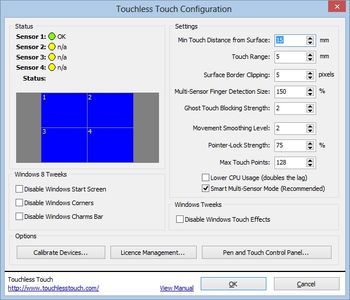

Step 4: Calibration Step 1
This is the most important step. If you get this step wrong the results will be poor. Take some time to do this correctly, and don't be afraid to repeat this process until you are happy with the results.
Go to the notification area in windows (the icons in the bottom right corner of the screen) and find the icon with the white hand with a finger pointing. Right click it and choose Configure.
If the message under Status says "Service Not Responding" then restart your computer and try again.
Hopefully you should now see something like the picture above.
Step 5: Calibration Step 2
Press the Calibrate Devices button and follow the on-screen messages. Make sure you read each one carefully and follow the instructions in order.
There are a number of steps. The last being the most important one. These options fine-tune the set-up to work the best. Work through these from the top to the bottom, one at a time until you are happy with the results. The software will show you simulated touches as you touch the surface.
When you are happy with the results press Save and you will be returned to the configuration screen. If all is well, the first dot should be green. Press OK and wait for about 5 seconds. Your new touch screen is now active!
