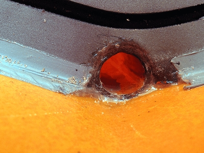

Next step was to feed the tube through the new bulkhead hole from the cockpit side. I feed the tube all the way through the rear compartment and up the back end until it sat flush to the top. Mark the length of hose, remove and cut.

The bulkhead is double walled so the first thing I did was put a large amount inside the bulkhead hole, making sure there was enough to work with once I put the tube in. I also put a good working amount on the outside of the tube that was going through the bulkhead. I inserted the glued tube end through bulkhead from the dry compartment site, gently rotating it back and forth to make sure that all surfaces had good contact with the glue. Once through and flush to the other side I then applied more glue to both ends of the bulkhead to make sure any openings where completely sealed.

Once home I set the kayak up against a wall and started washing it down. As expected, the cockpit filled up with dirty water. I opened the cover the rear compartment and checked it for leaks. TOTALLY DRY! Buh-yah!
I pulled out the drain plug and WHOOSH! All the water quickly drained and I was able to finish washing out the inside of the cockpit neither fuss nor muss.
