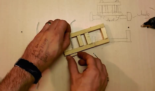

Step 3: Drill and Glue the Front Support
First, take your 2 x 12cm pieces and use a pencil and ruler to mark 2 points 2.7cm in from either end.
Next, use a drill with a 4mm drill bit to drill holes at your marks.
After that, take your 2 x 12cm pieces and 4 of your 2-3cm pieces and line them up line in the first photo, making sure there's a 1cm gap between the middle 2 (3cm) pieces.
Add a dab of hot glue to the end of each piece of wood and press them together.
Optional: Add card triangles to each join for extra step.

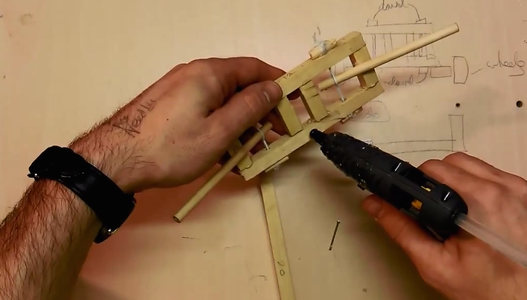

Step 4: Threading the String for the Arms
First, cut yourself 2 x 15cm pieces of string. Now for the tricky part!
I found in hindsight that wrapping a short piece of sticky tape around the end of each piece of string (so it looks like a shoe lace) helps stop the string unravelling and eases threading it through the holes).
Thread one end of the string through one hole, through the space between and out the other hole.
Next, loop the string around one of the 2-3cm pieces of dowel and thread it back down the same hole is just came out of. Look at the photos for a guide here!
Pass the string through the gap underneath and through the original hole you started with.
Now, tie the two ends of the string over another 2-3cm piece of dowel, knot it and trim the excess string.
Repeat on the other side.
Finally, gently push two of the 10cm round dowel between each of the paired pieces of string (so one's on either side) and twist the 2-3cm pegs (in the same direction!) so the string begins to tighten around the dowel. Count the turns as you do this and, once you can pull the arm back and it springs back into place, repeat on the other side with the other arm.

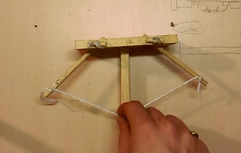

Step 7: Attach the String for the 'bow'
Now, take your string and stretch it between both ends of the firing arms.
Measure the length and add around 10cm to make tieing off easier.
Tie each end of the string to the arms, making sure the arms are slightly under strain when let go. This will help the arms to not lose force when you let go of them.
Optional: use a knife to cut a little groove into the firing arm for the string to sit in, or add a dab of hot glue to hold it in place.
