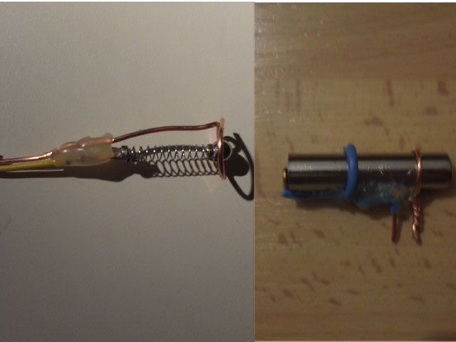

4. L2 - 2 outlets for the motion sensor (star power)

This was the most interesting part of the whole process. I've tried a lot of things as the strum bar, but nothing succeeded. So I had to make one... I took apart a small switch, put a broken drill-bit into the upper part of the switch (not the electric, but the mechanical), because it is hard, so it won't break (it will be pushing the buttons). After that i cut the trigger-pad in half, soldered it (common GND!!) glued the button gums to the trigger pad, placed it to the switch as seen on the pic and glued the whole thing. It works perfectly!!!!!
