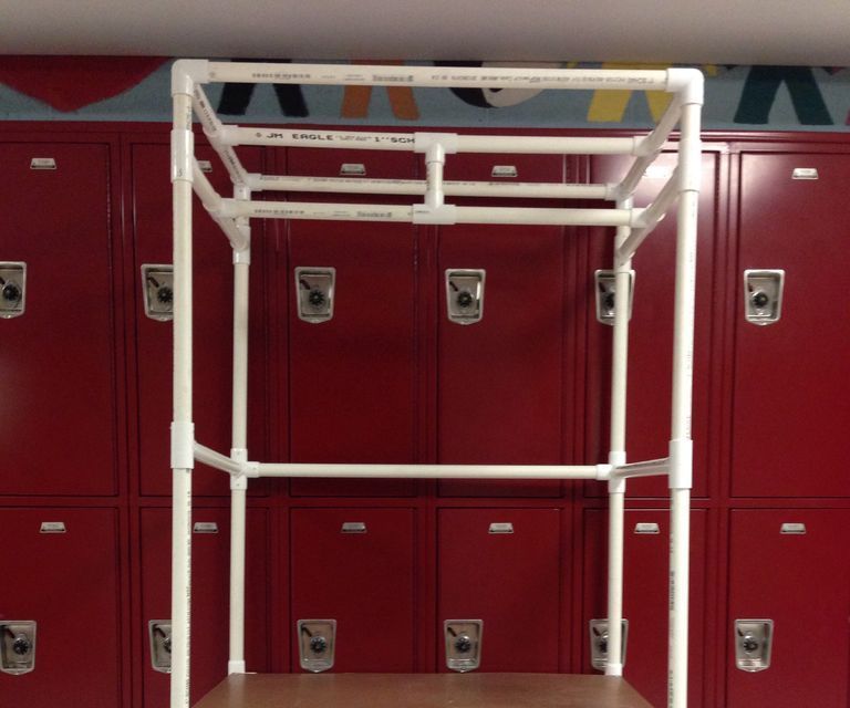

Step 4: Back Assembly
The chair is broken down into 3 sub assemblies. The back of the chair, the head-rest, the seat, and legs.
The first sub assembly that is advised to build first is the back of the chair:
As you can see in the final picture there is 3 spines that make up the back of the chair.
Start with the the left spine.
The order of the fittings from top to bottom should be T-piece, T-piece, T-piece, Cross, Cross, T-piece, T-piece, Cross-side outlet.
In between each fitting put the 2in pipe, all the fitting should be flush together.
Repeat this same process for the right spine. They should be identical.
For the center spine, the order from top to bottom is cross, cross, cross, cross, cross, cross, cross, and t.
These fittings should be flush to each other with the 2in PVC in between to connect them.
After all three spines are made, take the 5in PVC to connect all three spines. So the 5in will connect the left spine to the middle and the right spine to the middle.

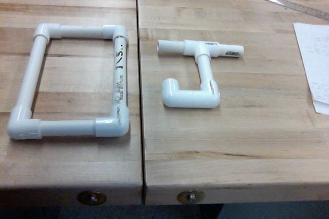

Step 5: Head Rest Sub Assembly
For the head rest, you need the following fittings:
4 90-degree elbows
1 T-fitting
Take the four elbows and lay them out so that they make a square.
Insert 2.5 inch pipe in between the side elbows.
Insert 4.5 inch pipe in between the top elbows.
The T-fitting connects the bottom two elbows with 2.5 in PVC in between, and the T-fitting also connects to the cross of the back of the chair.
4 90-degree elbows
1 T-fitting
