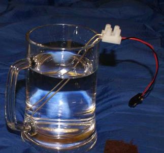

First, you don't really need all the terminal blocks for just one generator, so take a sharp knife and cut two from the end of a string of 12. ( Mine was a 12 pole terminal block.) Now you should have a 2 pole terminal block.
Slide one 6" piece of 99.9% pure fine silver into the terminal block until it can be caught by the screw when the screw is tightened. Do the same with the second so that it is protruding the exact same length from the block on the same side of the block. ( see photo.) Tighten down the two screws to secure the wires in place.
Take the 9V battery connection and strip the wire ends so there is 3/8" bare on each wire. Fold the bare wire back at the mid-point of each bare section so there is a 3/16" double of bare wire. This will give the terminal block screw more to grip on to. Insert one wire into each of the poles on the terminal opposite the 99.9% pure fine silver wires. (see photo.)
This portion is optional as it depends on the container being used, but you can bend the wires slightly so the terminal block rests on the rim of the container, outside the container. (see photo in next step also.)
Step 3: Make Some Colloidal Silver.
Now that you have the device, lets hook up the POWER!
Plug in the battery. Simple and easy.
A note here to never allow the two wires to come into contact with each other, or anything metal, when the battery is hooked up. It will short the battery and cause sparks.
Take a glass ( always glass - no plastic - no metal - just glass.) and fill it almost full of distilled water. Slide the 99.9% pure fine silver wires (I'll call them electrode from now on) into the water.
After a short time (15sec.) you will see bubbles form on the negative electrode and what seems like smoke will come from the positive electrode. This smoke-like material is silver being emitted into the water. About 0.0001 microns in size.
You will also notice that the positive electrode will start to tarnish, or turn blackish. No problem. Pull the electrodes from the water when you feel uncomfortable and wipe them off with a napkin, making sure not to allow them to touch each other. Now put them back in and continue to make colloidal silver.
You may notice that the positive electrode in the photo is getting thinner than the negative electrode. This device has about 40 hours on it with 14-AWG 99.9% pure fine silver wires. I am to the point where I will reverse the polarity of the electrodes by switching the location of the wires on the terminal block. The other electrode will than begin to emit the silver and tarnish.

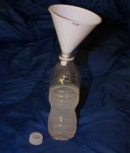

Transfer the colloidal silver into a storage bottle.
Wash out your glass and store it away.
