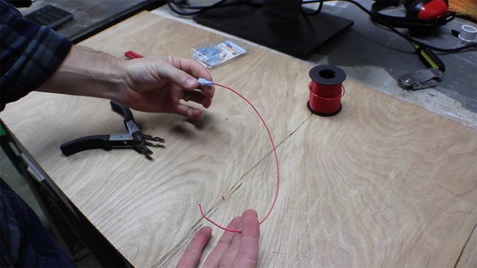

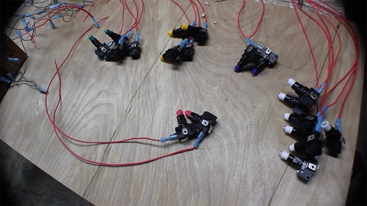

Step 3: Prepare Your Wiring

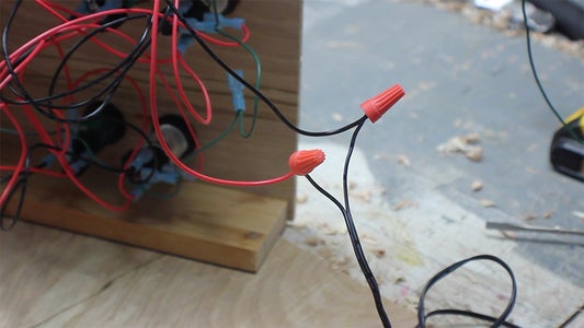

Make a wiring daisy chain with one female plug per button.
Make three daisy chains in red, black, and green.
Make a single wire, with female plug, for each button.

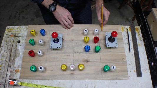

Step 4: Make Controller Board

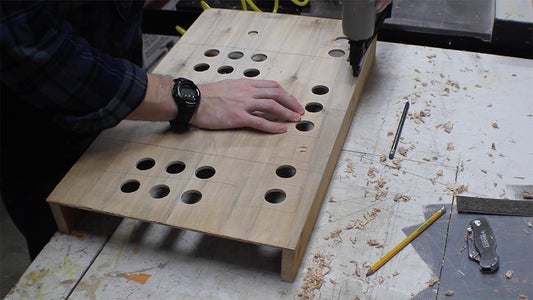

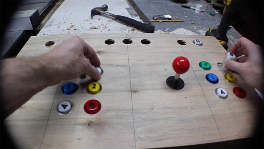

Layout your control board (this was a very rough prototype, ignore actual placement in these photos).

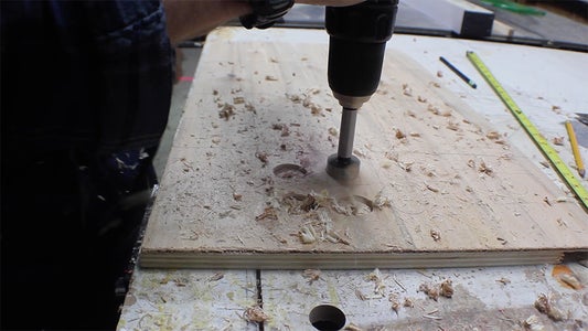

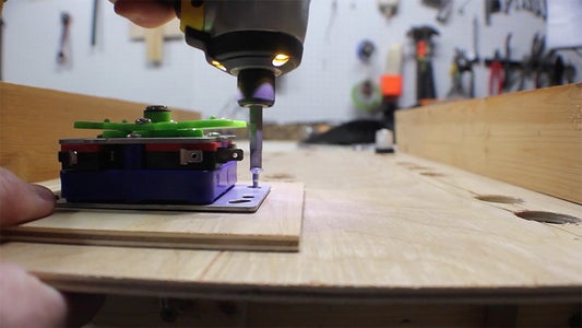

Drill holes for each button and joystick.
Add a simple frame to lift it off the table. Screw in the joysticks from the back side.

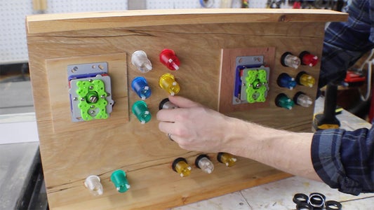

Drop in buttons from the front. Screw on rings from the back to hold buttons in place.

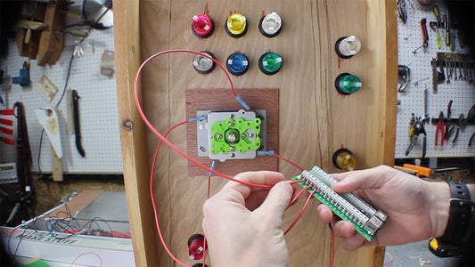

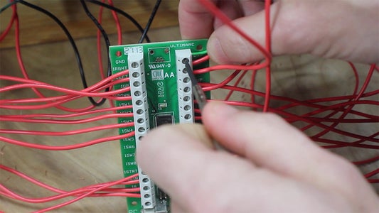

Step 5: Wire Up the Controls

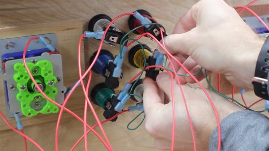

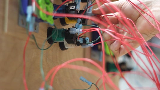

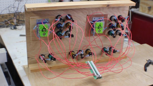

The wiring here can get REALLY out of control, so you'll need to do some clean up wire zip ties, etc.

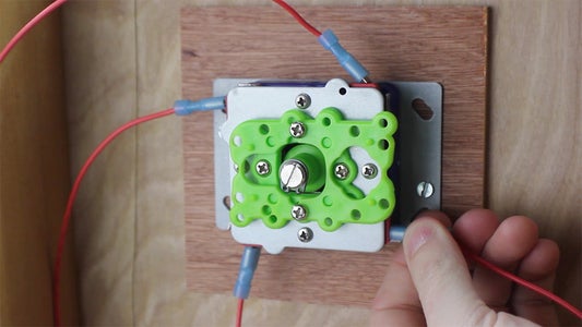

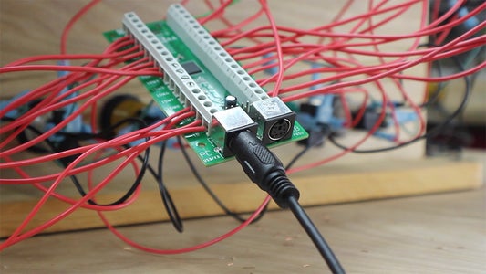

Attach wires as shown on each button.
Also add wires to the joysticks (no LED = no red & black daisy chain) Wire the joysticks and all buttons to relevant terminal on IPAC. Attach the end of the green daisy chain to the ground terminal.

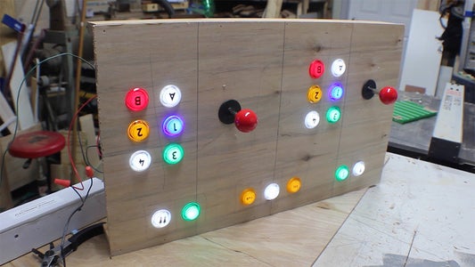

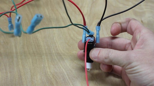

Step 6: Wire Up LED Buttons
Daisy chain the right sides of each button (red) and the left sides (black).
Wire the ends of the daisy chains to a 12v power supply.
Plug it in for light up buttons!

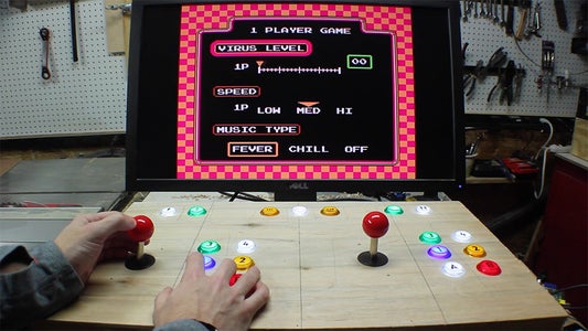

Step 7: Plug It In.. AND PLAY!
Plug in IPAC to the Raspberry Pi (via USB).
PLAY AWESOME GAMES FOR HOURS!!!
