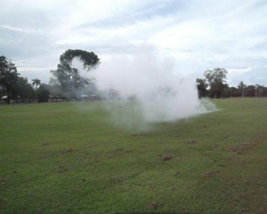

flat, patty shape , if ignited from the center and covered in maybe 1-2 layers of foil will completely combust in under a second giving you the closest thing to a ninja style contact exploding smoke bomb . not recommended in windy conditions, works best indoors
round, grenade shape (as in video) , will produce a large amount of smoke over a short period of time, though is recommended for windy conditions as it will make a large cloud of smoke
thin tube shape, this is for if you choose to pack the smoke bomb into a small paper fireworks tube
, it will burn considerably longer and make quite a large amount of smoke, and is suitable to use in multiple areas (use more than one smoke bomb) to quickly produce a smoke screen.
