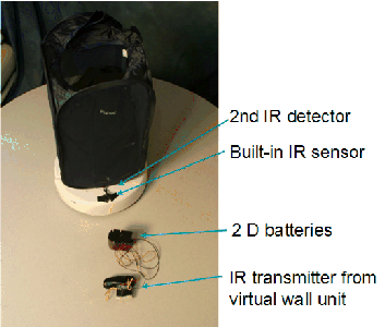

Step 1: Covering the IR Sensor
Attach electrical tape to cover all but a small slit of the IR sensor on the front of the Create robot. Dismantle the virtual wall unit and extract the small circuit board at the front of the unit. This is a bit tricky because there are lots of hidden screws and plastic mounts. The IR transmitter is on the circuit board. Cover the IR transmitter with a piece of tissue paper to avoid IR reflections. Attach the circuit board to a strap or elastic band that can wrap around your ankle. Wire up the batteries to the circuit board so that you can have the batteries in a comfortable place (I made it so that I could put the batteries in my pocket).
Wire up the 2nd IR detector to the DB-9 connector and insert into Cargo Bay ePort pin 3 (signal) and pin 5 (ground). Attach the 2nd IR detector to the top of the existing IR sensor on Create and cover it with a couple of layers of tissue paper until the 2nd IR detector doesn't see the emitter at a distance that you want the Create robot to stop to keep from hitting you. You can test this after you've hit the Reset button and watch the Advance LED to go on when you're at the stop distance.
Step 2: Attach the Basket
Attach the basket using the 6-32 screws. I just mounted the basket to the top of the Create robot. Also slide in the back wheel so you place weight on the back of the Create robot.
