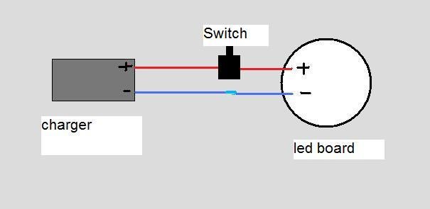

Step 2: Make the Circuit
Check the circuit diagram and join the components according to it (No forcing!)
Check the pin connections correctly either using a multimeter or a LED, and join positive to positive and negative to negative. Doing it the wrong way MAY (not the month!) damage the components.

see the pictures on flower carpet for modified circuit diagram and pictures;
