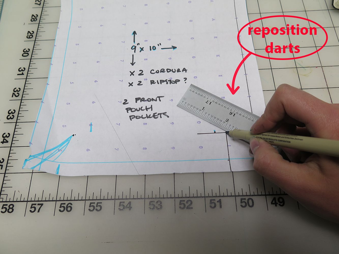

Now start enlarging the flat view drawings you made for each part into patterns.
Your bag will only be as good as your pattern so spend the time making a great pattern and save yourself the frustration of mismatching edges and seams later.

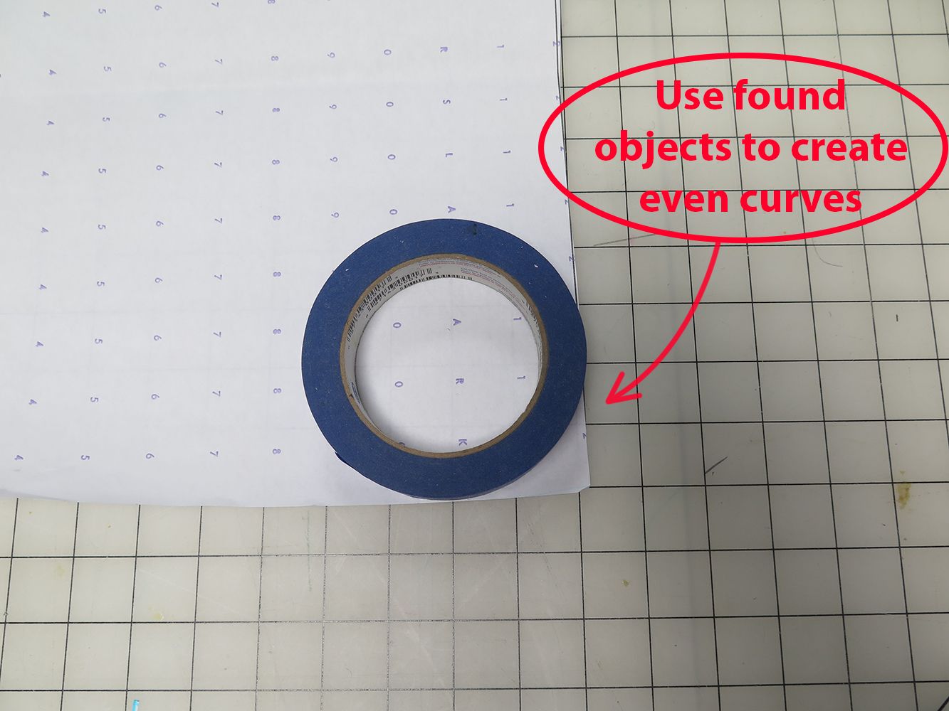

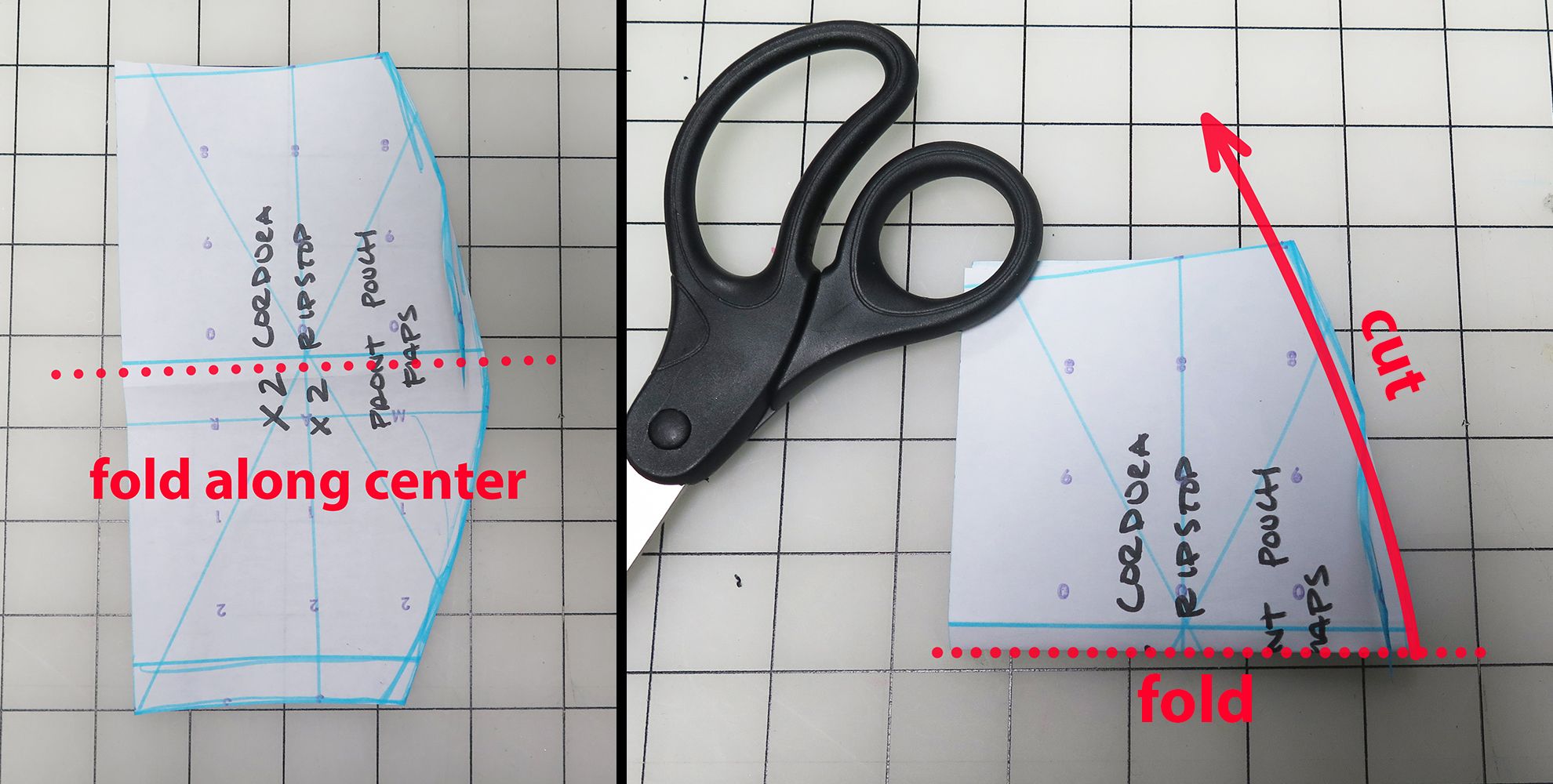

Here are some tips to make your pattern accurate.
To keep your patterns and markings clear and get crisp edges and corners
For making curved edges the easy way!
To make sure your centered curves are symmetrical
Some helpful information to always include in your patterns. It can be easy to confuse pattern pieces when they're just blank pieces of paper all roughly the same size. Marking your pattern will also save you the frustration of accidentally mistaking a pattern for scrap paper and throwing it out (I've done that too many times!)
I've attached my pattern at the top of this step if you want to use my design or some components of it. It's not very printer friendly but the shapes are all fairly simple for you to recreate on paper. Just follow the dimensions provided.

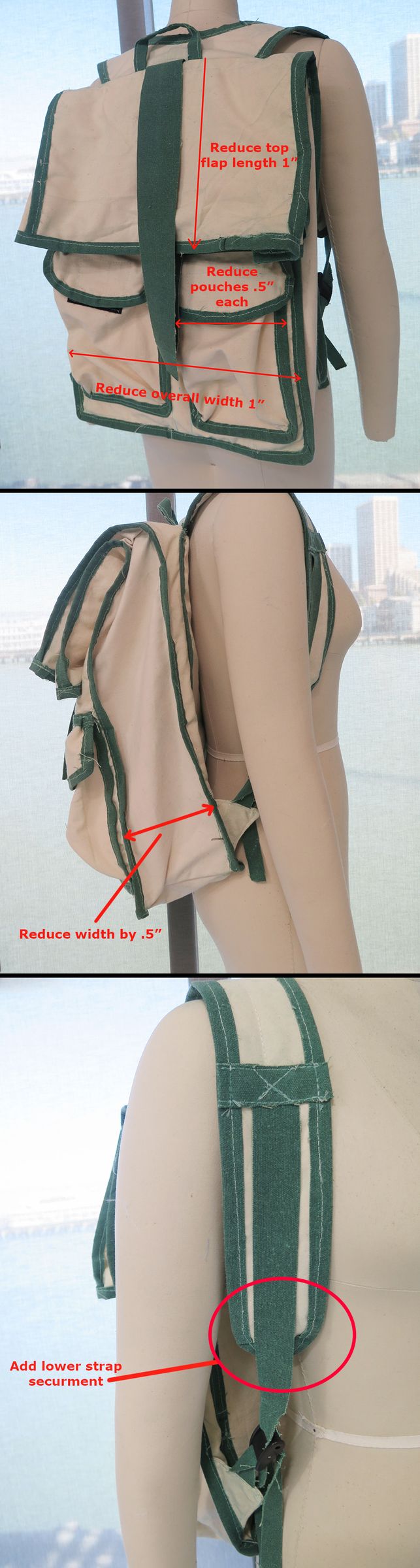

The prototype might look a little silly but it served it's purpose. Here's some of the changes I was able to realize after making it.
Remember to take lots of notes while making a prototype. I find it useful to document what order I did steps, important pointers to remember or things to fix on the final version.

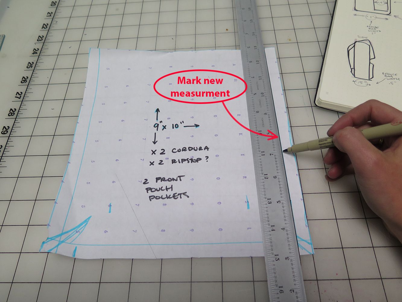

Draw out any changes you want to make and document how that might effect each individual part. I like to redraw all the pattern parts I need to change, record their new dimensions and any other alterations. Be sure to mark off as you make each alteration so you don't "double edit" a component. I marked each part with a blue dot after I altered the pattern.
Mark your new measurements in a different color to avoid confusion.
Remember to make changes to other pattern marks to reflect the new dimensions.

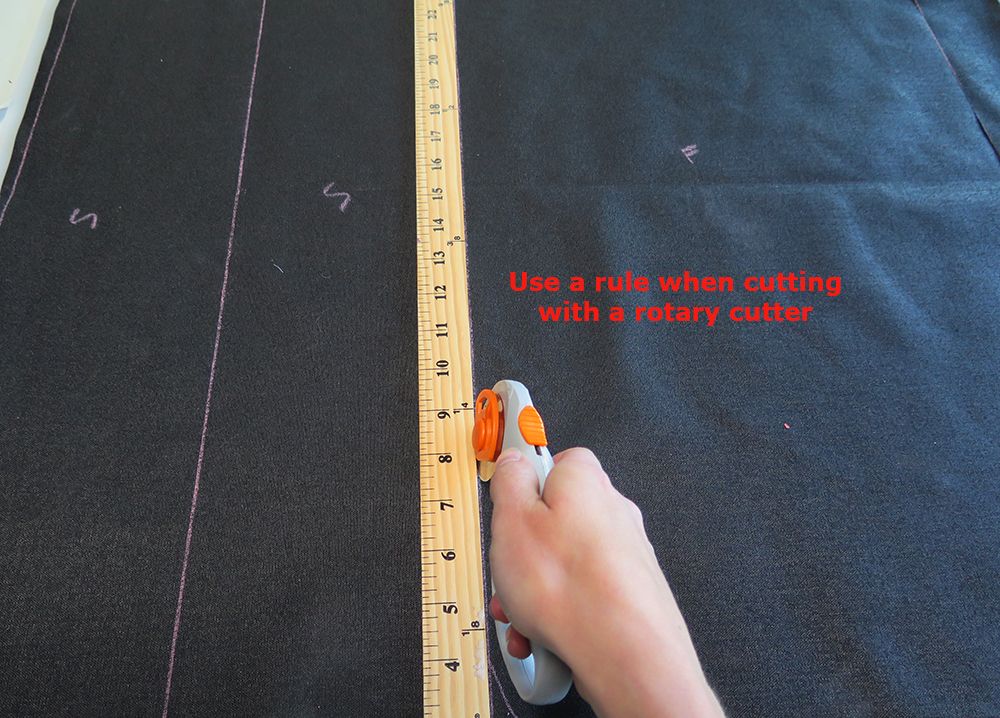

If you're comfortable with cutting fabric you can line straight edges up end to end to conserve time cutting and marking as well as materials. However if you don't cut exactly along the line you'll mess up one of the pieces on either side.
Using a straight edge when cutting with a rotary cutter can help avoid this situation. However a straight edge won't help you when cutting your fabric with scissors.

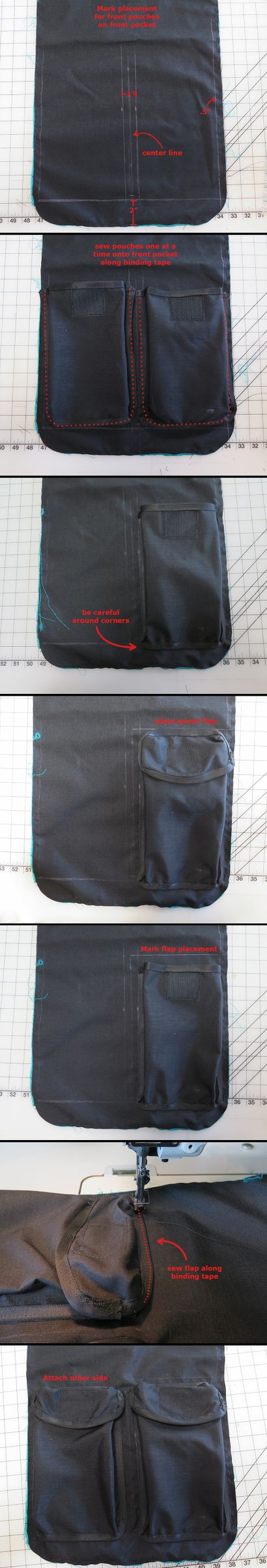

Step 5: Sewing Pockets
I started sewing my backpack by preparing the front pouches. This included using a basting stitch (a basting stitch is just a loose stitch used to tack pieces of fabric together it is not structural so you don't have to knot the ends) to hold together the lining and outer fabric, adding darts to give the pouches dimension, adding binding tape to finish the edges and increase durability, and attaching velcro for closures.
If you did not include pouches in your design you may skip this step.

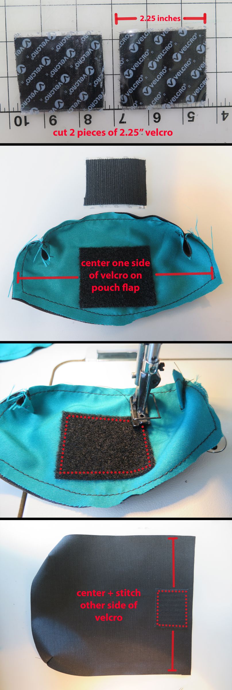

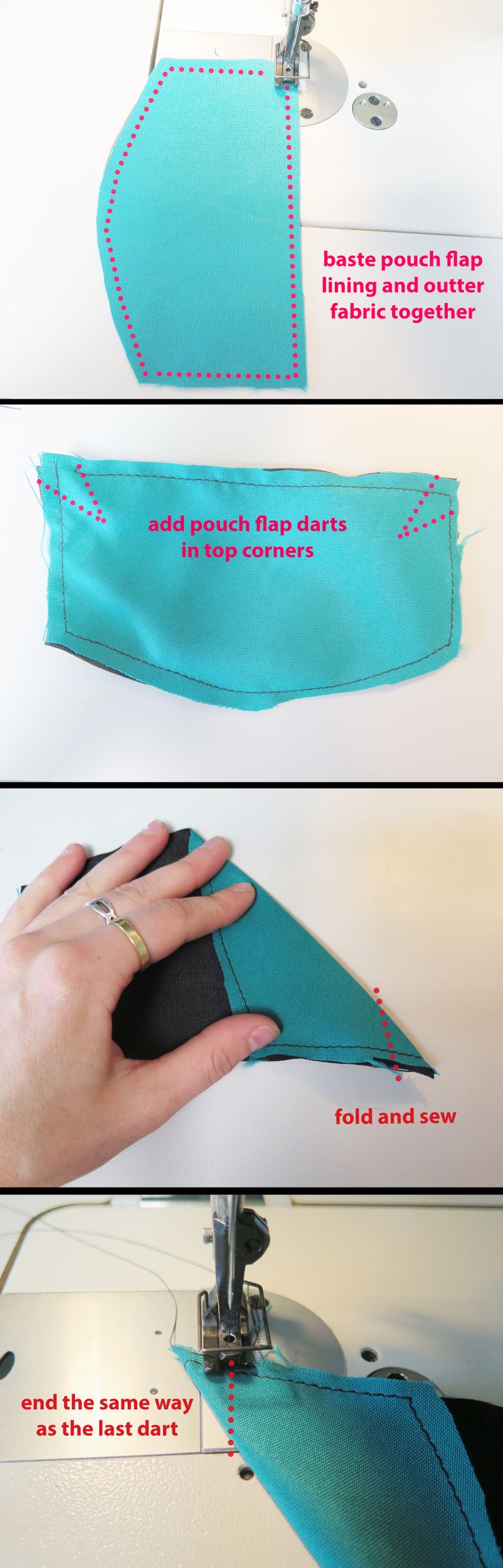

Take both lower main pouch pieces and follow the instructions below.
These instructions are for the pouch flap
Adding velcro

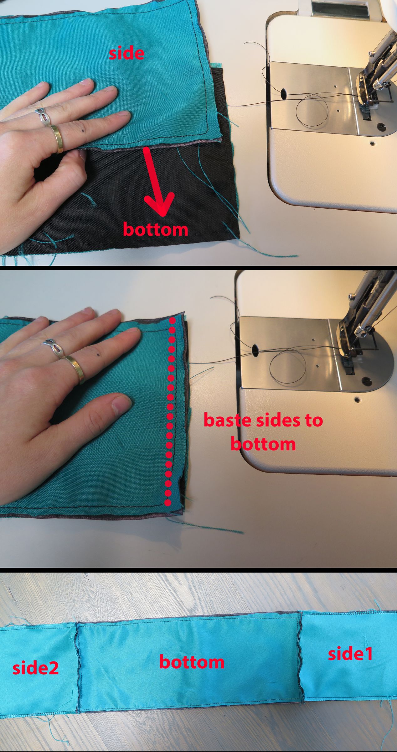

Step 6: Preparing the Side + Bottom Pieces
Follow these steps to prepare the side and bottom pieces.

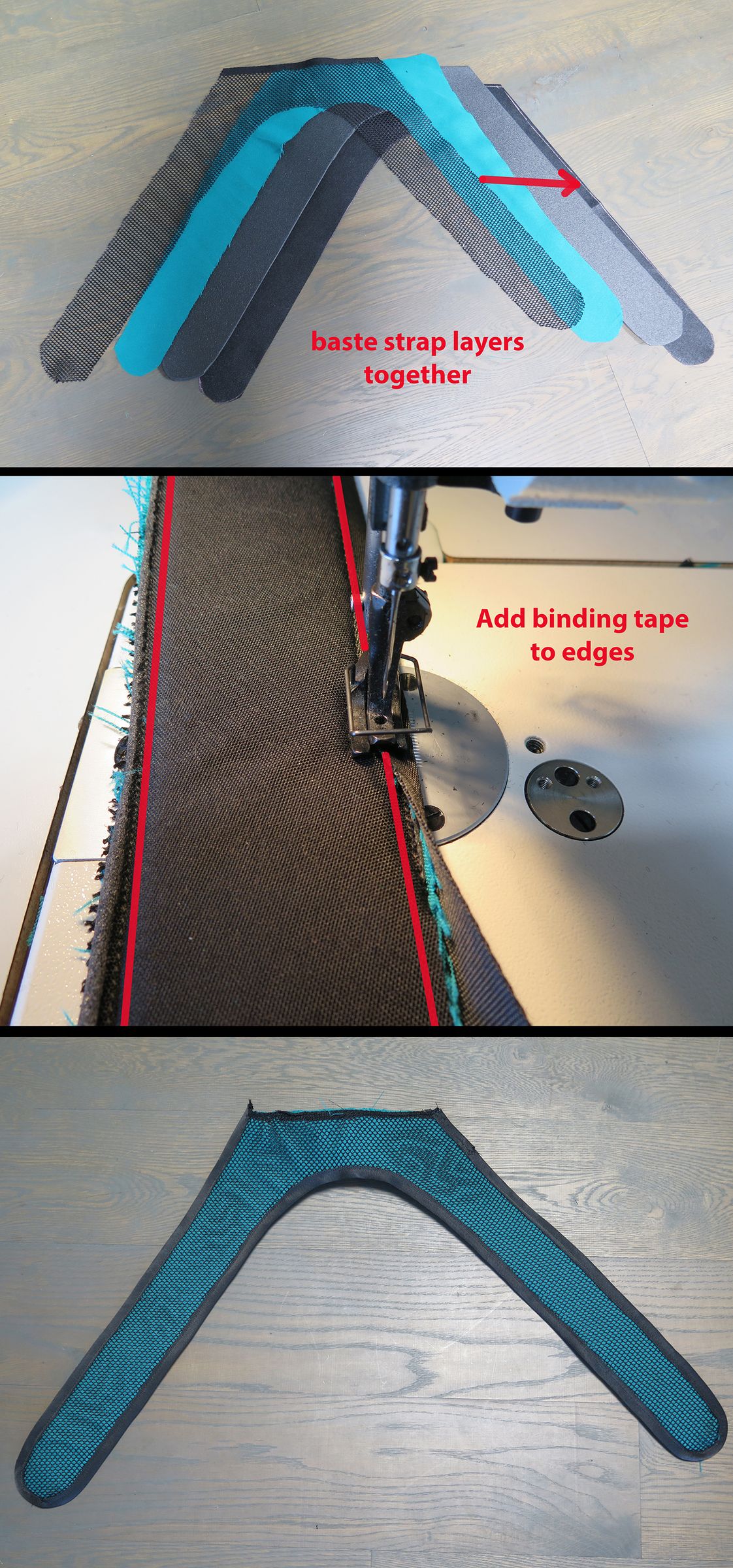

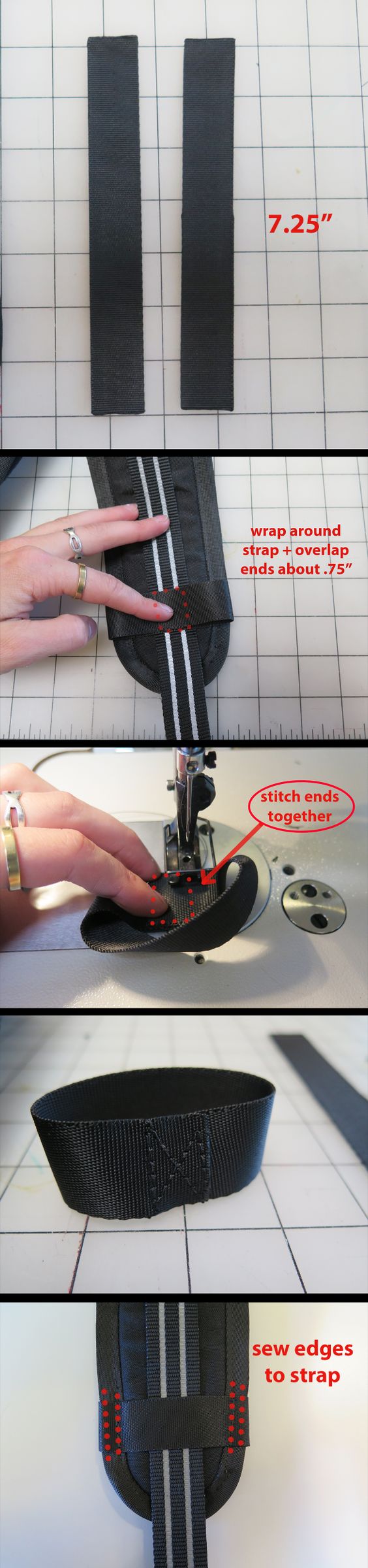

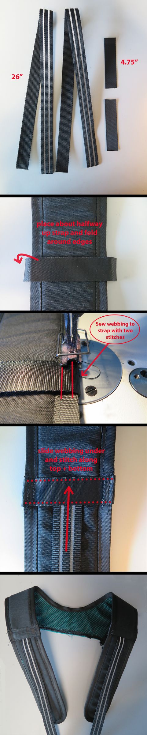

Step 7: Sewing the Straps
Follow these steps to make the straps

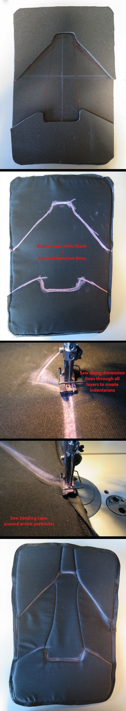

Step 8: Creating the Back Padding
How to make the back pad!
Note that I used two layers of 1/8th inch foam to give extra dimension. You don't have to do this! and probably shouldn't if you aren't using an industrial machine.
The chalk lines can be wiped off later.

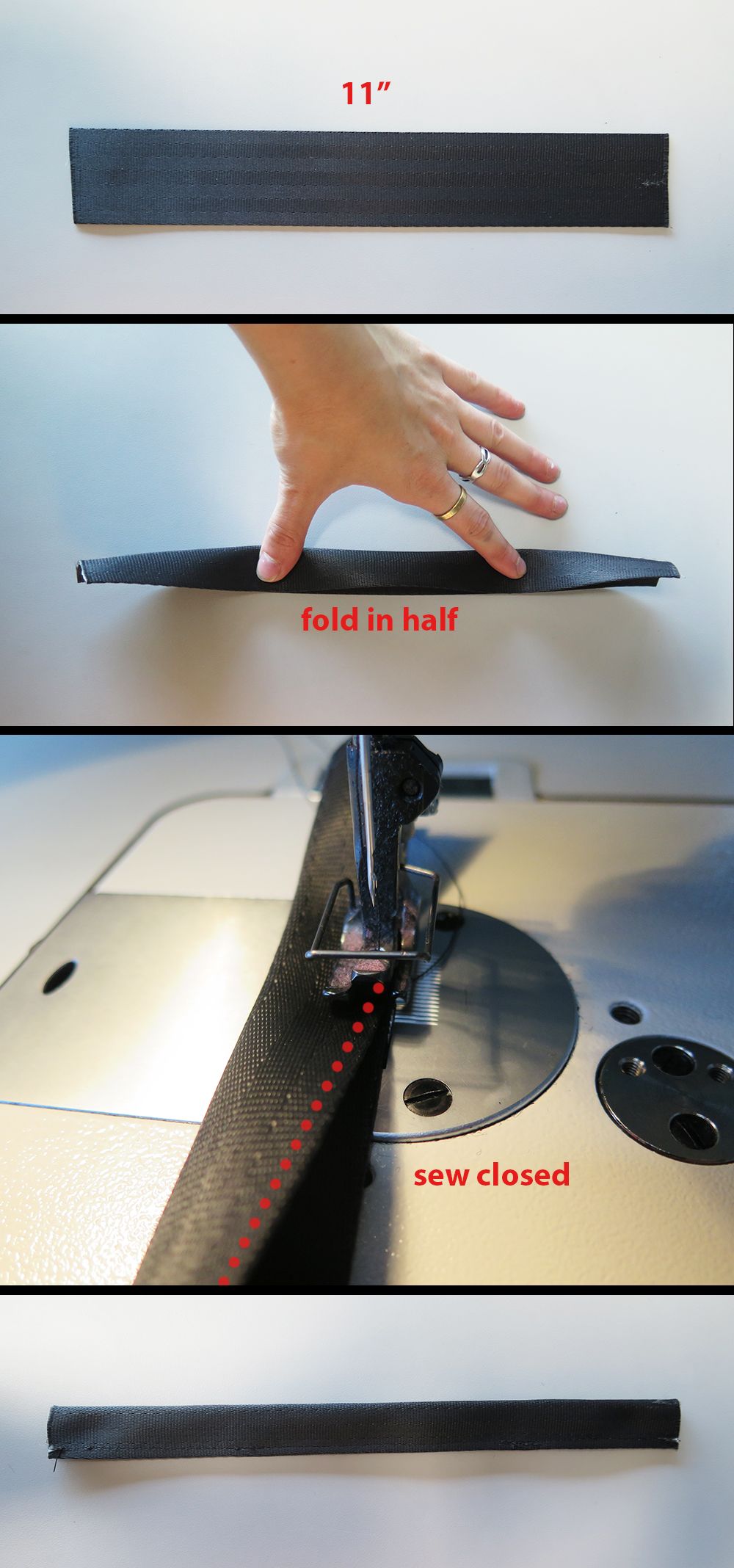

Step 9: Making the Top Handle
Making the top handle out of 2" seatbelt webbing

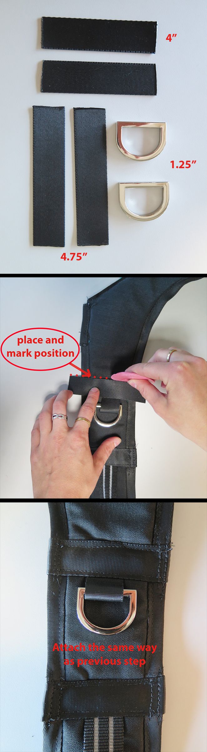

Step 10: Making the Lower Strap Attachments
Making the lower strap attachment (small triangle of fabric that sticks out of the bottom of the back of a backpack)

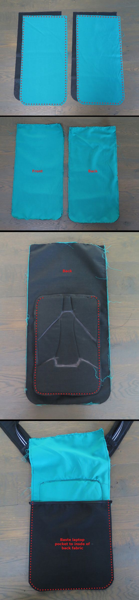

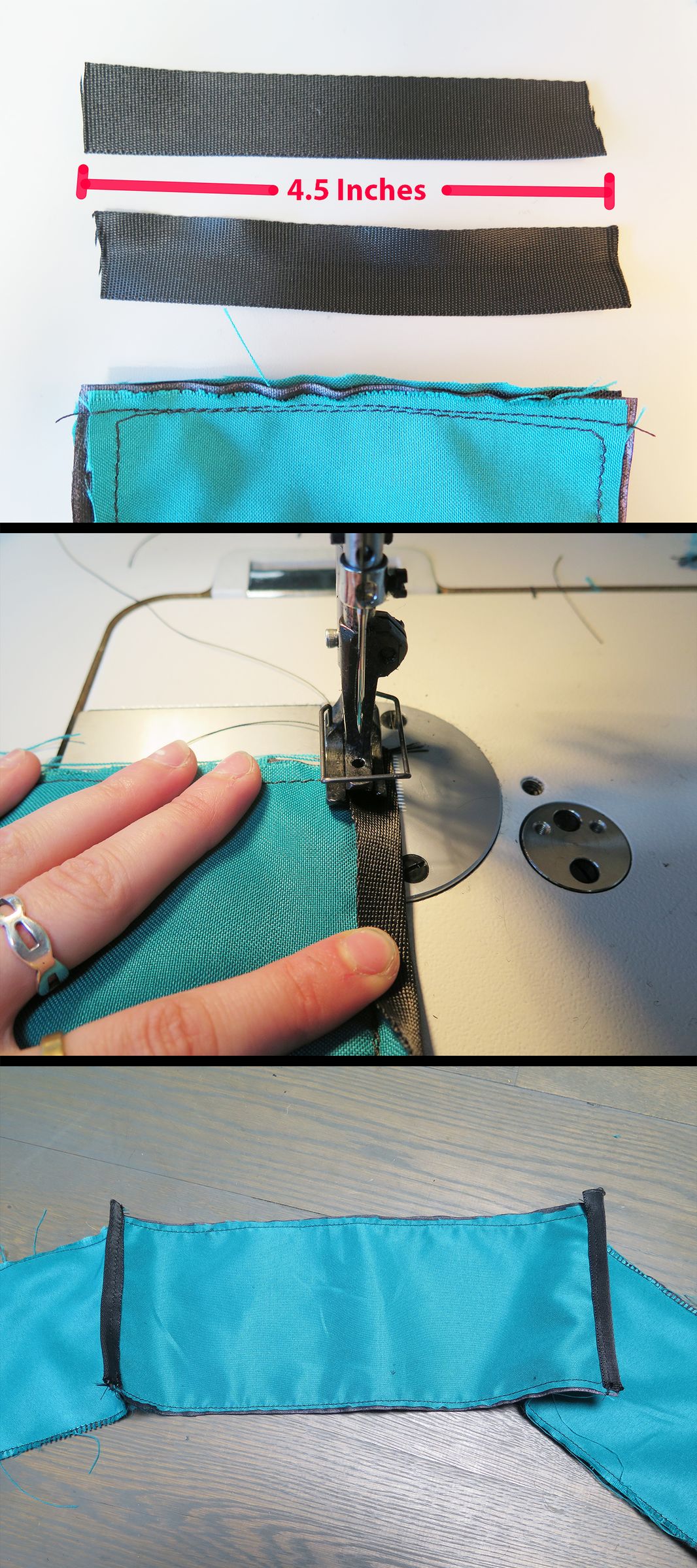

Step 11: Preparing the Internal Laptop Pocket
Assembling the internal laptop pocket

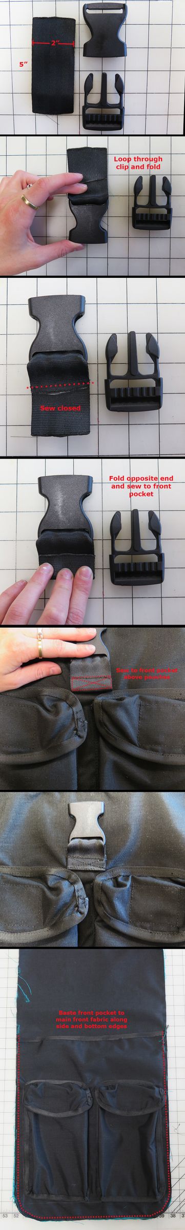

Step 14: Attaching the Front Pouches
This step covers attaching the front pouches and lower clip to the front pocket fabric.
Attaching the lower clip

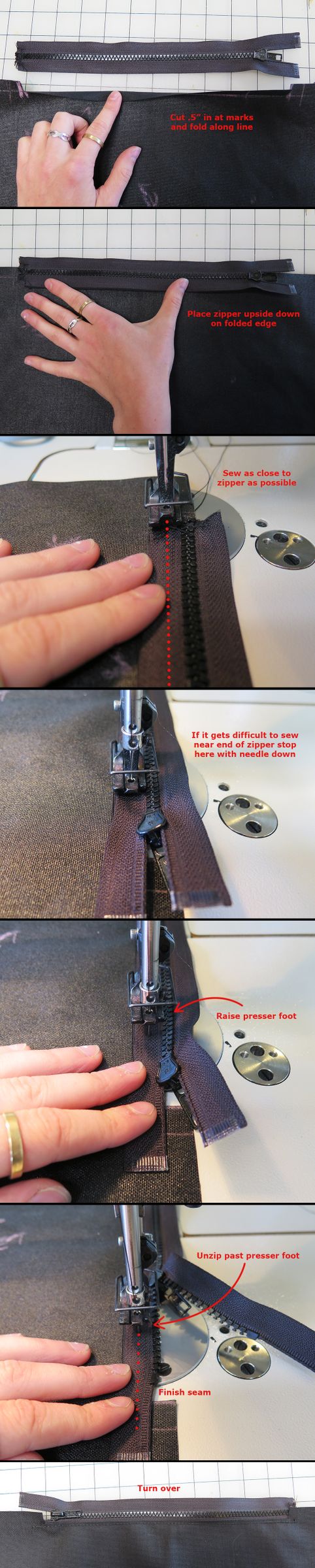

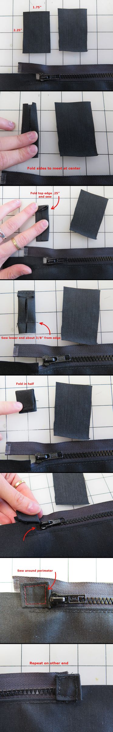

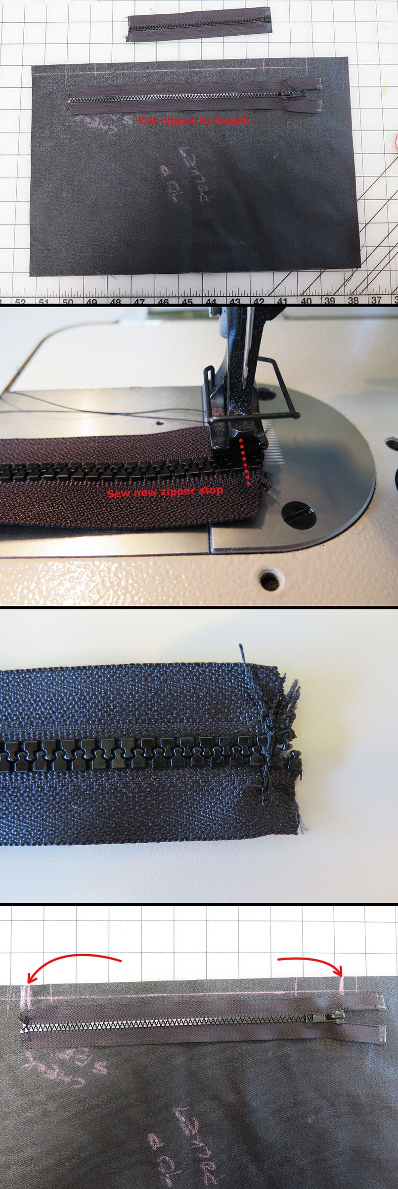

Step 15: Adding the Zipper Pocket
Adding a zipper and installing the inside pocket

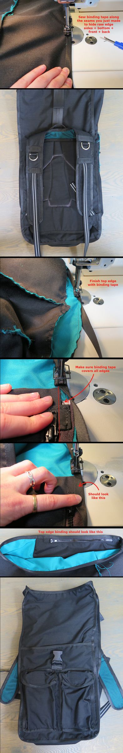

Step 18: Fixing Uneven Top Edges
Like me, You probably ended up with some uneven top edges despite following the instructions perfectly. Here's how you can quickly fix them.
Step 19: Binding the Outer Raw Edges
The final finishing touches, adding binding tape to the outside edges.

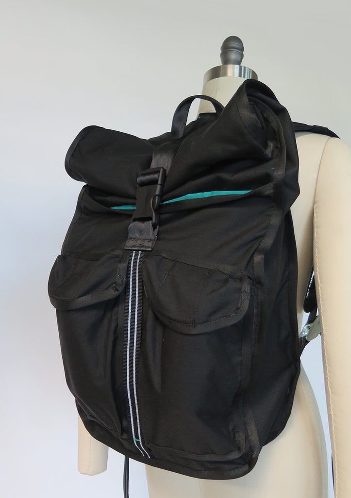

Step 21: Finished!
You've just designed and sewn your own backpack from scratch!
That's awesome!
Test it out and see how it works. You might even find things you'd like to change or wish you'd done differently. I have a bunch of new features I'd like to include if I make a version 2!
