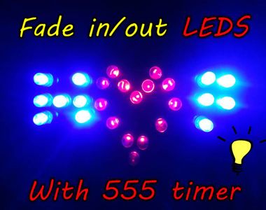

here is a picture from inside the box !
i have used a clear blue LEDs for the litters, and red LEDs for the heart!

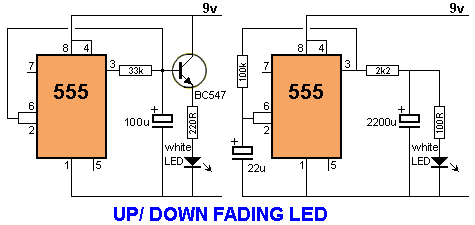

each LED was connected with 330R resistor in series to limit the current
i have used and modified the attached circuit to suite my needs
