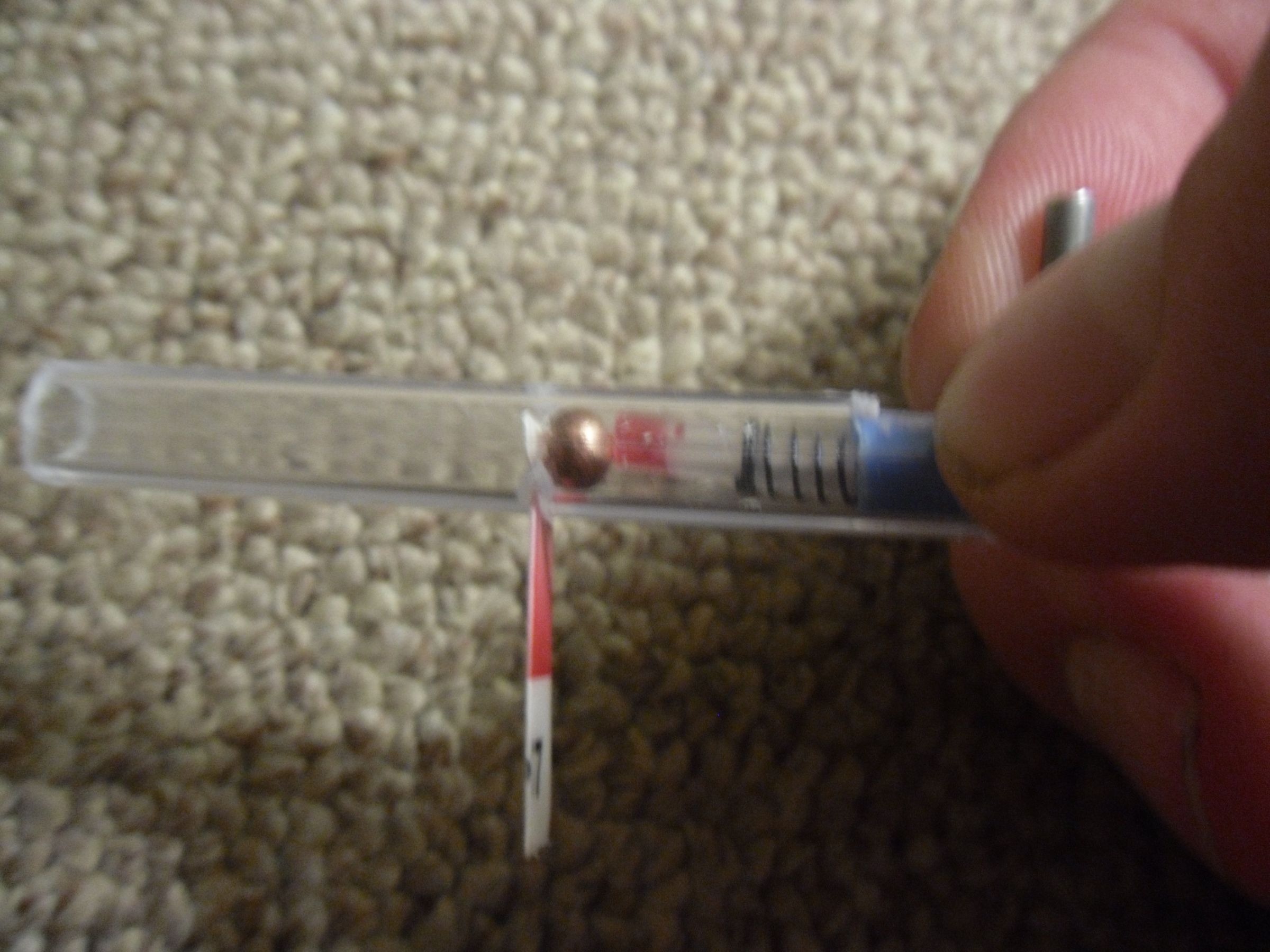

-Hold the bolt assembly parallel to the remaining part of the mechanical pencil.
-Mark on the housing where the bolt is.
-Using the razor blade cut from the TOP (the end you didn't cut off) of the clear housing piece to where you marked so that you make a track for the bolt. It is imperative that you cut at this end
-At the end of bolt track, cut out a little notch on the right side the size of your bolt piece.
-Insert the bolt and firing pin assembly into housing.
-Widen the newly cut hole so that a BB can roll down the housing smoothly.
-If the test BB doesn't go down smoothly, widen hole or blow out any obstructions (plastic shavings).
Step 5: Trigger Mechinism
-About .5cm from the end of the firing pin make a slot on the UNDERSIDE a little less wide than the width of the entire of the housing using the razor blade
-Cut a piece from your plastic the size shown in the picture below. Make sure it fits in the slot you made
-Insert newly cut plastic piece into designated hole so that it obstructs the path of the firing pin
Step 6: Test Fire
-Put bolt and firing pin assembly into housing with trigger in place
-Insert BB one of two ways
-One- Weak configuration. Cock gun with no BB at first, then roll BB down the end
so it goes from left to right: BB, trigger, firing pin
The advantages of this configuration is that it doesn't put as much stress on the
trigger therefore making it last longer.
The disadvantages are that you can't aim downward and the BB doesn't go as far
-Two- Power configuration. Open bolt then insert BB directly in front of firing pin. It
should go from left to right: trigger, BB, firing pin.
The advantages to this configuration is that you can aim downward without the BB
falling out and that it shoots farther
-When desired configuration is set, pull trigger downward. The BB should fire. Enjoy!
