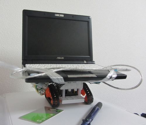

Introduction: How to Make a Button More Sensitive (for Robot Sensors)
If a robot is built using 3v hobby motors, it may not have sufficient force to trigger its bumpers to let it know an obstacle has been hit. This is an easy fix that takes only a few minutes. It’s best to use medium sized buttons or larger unless you have very very small fingers or are deft with tweezers.
