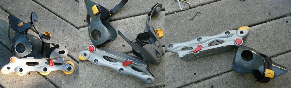

The first step was to remove the wheels
Using a power drill I remove the rivets from the toe portion of the skate.

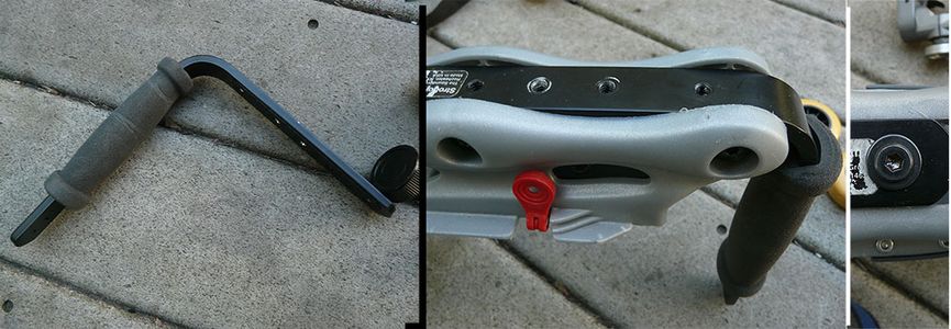

Next step we will insert a flash bracket that will serve two purposes.
It will be a handle and a base for the tripod head .
The flash bracket fit were the wheels were and it was secure with some bolts.

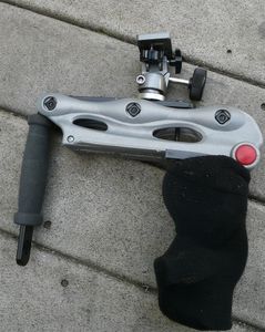

Step 3:
I secure parts from a minii tripod to the flash bracket.
Step 4:

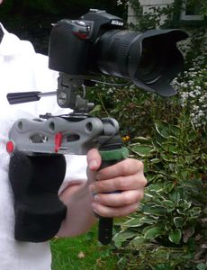

I filled the heel part of the skate with foam and added a sock to hold it together.
The remote was held in place with a Velcro strap.
This turn out to work better than expected I was able to follow the action and shoot using only my left hand.
I like it enough that I think I will be using it after i get my right hand back.
