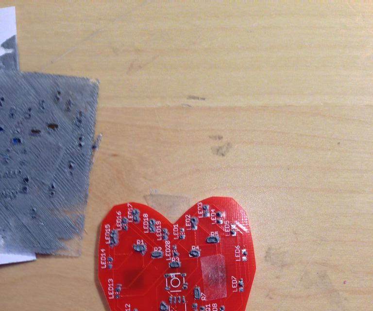

For reflow, apply flux paste to all the metal pads. A very small amount is all you need, just enough to hide the pad under a thin layer of paste. If you have access to a laser cutter, cut the paste layer out of a piece of transparency film and use that as a template.
It should look like this when you're done (image courtesy David R Reeves and Hack Manhattan)

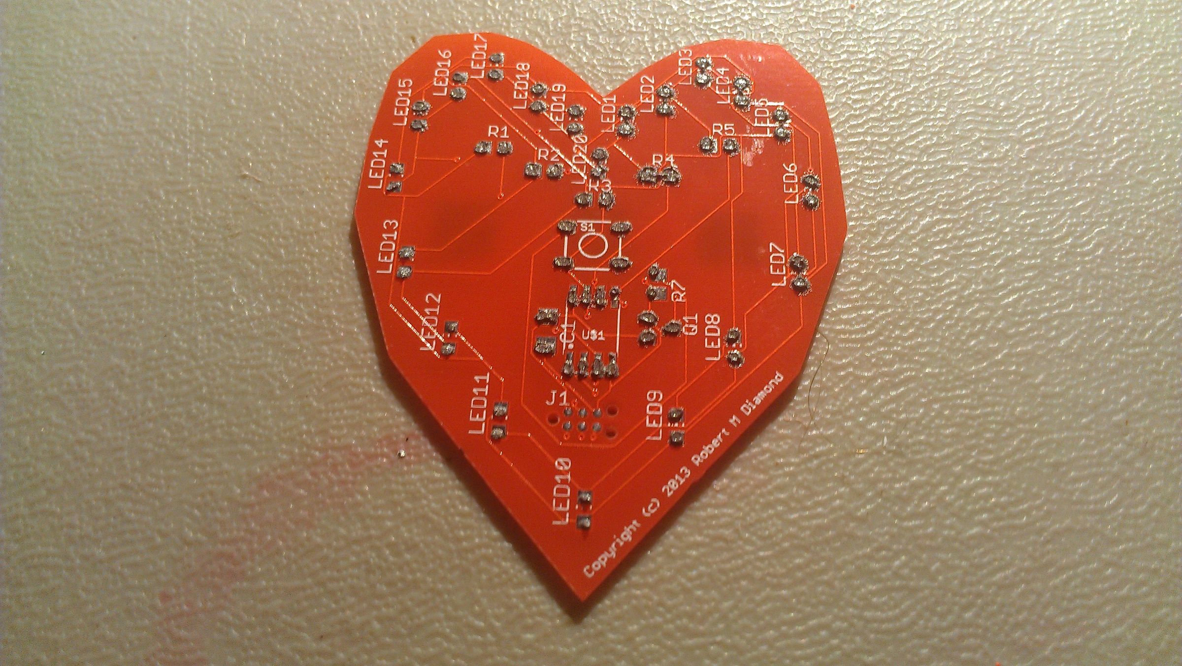

Step 2: Parts Placement and Hand Soldering
Just like with through hole soldering, you will place the shortest parts first (the ones that rise the least above the board surface), and incrementally up to the tallest.
The first parts we'll place are the resistors. These are not polarized, but do have a top and a bottom. The bottom is white and has no letters, the top is black and has the resistor value in white letters.
If you're hand soldering, find the pairs of pads along the top marked R1 through R5. Preheat one of the pads of each pair with the soldering iron, then melt a small amount of solder onto the pad while keeping the iron on the pad. The order is heat with iron, touch solder to pad, remove solder from pad, remove iron. You'll end up with a small dome of solder on one side, and the other side untouched. This is important. Next hold the resistor across the pads with the tweezers and on the pad that you put solder on, touch the iron to both the resistor and the pad. The idea is to heat the resistor terminal so solder will melt to it, then melt the solder on the pad so you're making a connection.
Next (hand soldering) wait a few seconds for the solder to harden - it will become less shiny when it solidifies. Solder the other resistor terminal to the other pad, then touch up the first pad as necessary.
For reflow, take the 5 3Ω resistors and place them on the spaces marked R1 through R5. The resistor should be centered as well as possible across the two metal pads. Hand solderers follow the same instructions as above for the other four resistors.
Next place (and/or solder) capacitor C1 and resistor R7. David's Photoset shows this really well.
Then the 20 LEDs. These are a challenge because they are polarized, the cathode needs to point to the top of the heart for all 20.
Finally the CPU and tactile switch.

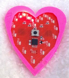

Step 5: Put in the Battery and Program!
If you bought a kit from me or Hack Manhattan, the attiny is pre-programmed, and you can skip this step.
I used a small JTAG connector by tag-connect.com to save some space.  These are $20, and the other end is a standard 6-pin molex to connect to an avr Dragon, JTAG mk2, or Arduino as ISP programmer.
Put the battery in the clip, taking care to have the + side up, to match the clip.
First do "make fuse" to set the fuses for programming.  If all is well you will see LEDs 17 and 18 flickering.  If you get errors about no target power or failure to enter programming mode, you probably have some loose or bridged connections on the attiny chip.  Go over these with flux and solder or solder wick as appropriate.
If the fuses program correctly, next up is 'make flash'.  This will load the actual firmware into the attiny.  Once this finishes you should see the Larson Scanner pattern.  Pressing the button should sequence you through pulse, alternating, and off modes.
