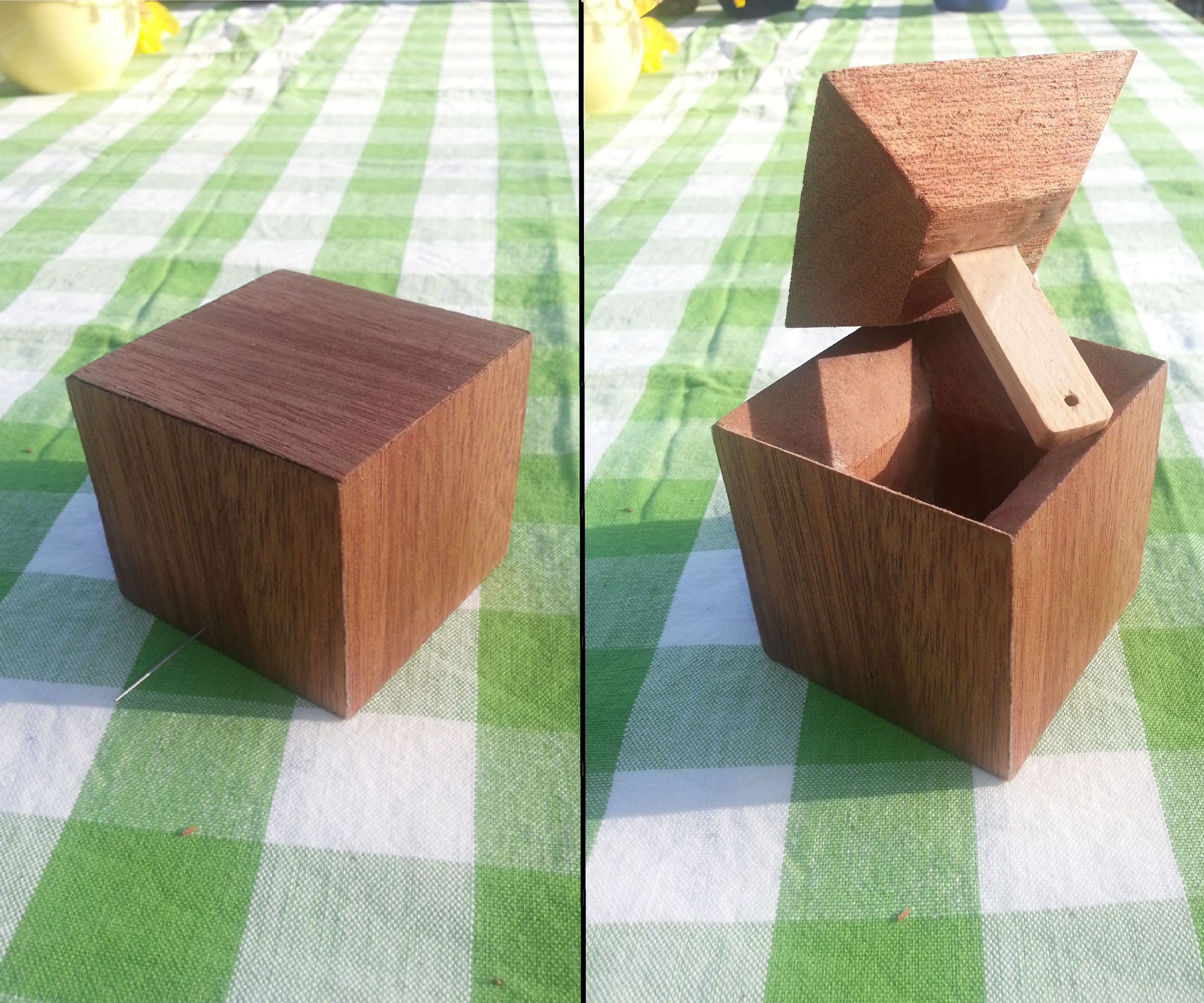

In this instructabe I will show you how to make a cube within a cube within a cube.
The process itself is not very hard but it takes some time making it.
The cube have no purpose, exept form maby getting people puzzeld about how you got them in there.

Step 2: Marking
Begin with sawing out a square wood piece. The length of my cube was about 6 cm, but it may wary vary depending on the drill diameter.
I recommend using a hard type of wood like I did. The wood I used was mahogny.
After marking the senter of all sides you are ready to go to the next step.
Step 3: Drilling
When you drill out the holes be very careful, so you don’t break the wood or cut yourself.
begin whith drilling out the lareger hole. But dont drill it to far in, and always make sure every hole is the same lenght.
Step 4: Cutting Out the Cubes
Now its time to cut out the cubes : ) be very careful while doing this, so you don’t cut  yourself or  brake the cubes. A sharpe kife is strongly recomended when doing this.
Step 5: Sanding
Now all you have to do is to sand it.
This takes some time and can be hard whit the inner cube.
As always begin with rough sand paper and go down to finer.
Step 6: Finishing
Now you can make a final finish by using some sort of oil or paint.
In the one to the right I used oliven oil. Oliven oil worked just fine.
Other alternativs can be:
Wood oil
Mineral oil
paint
