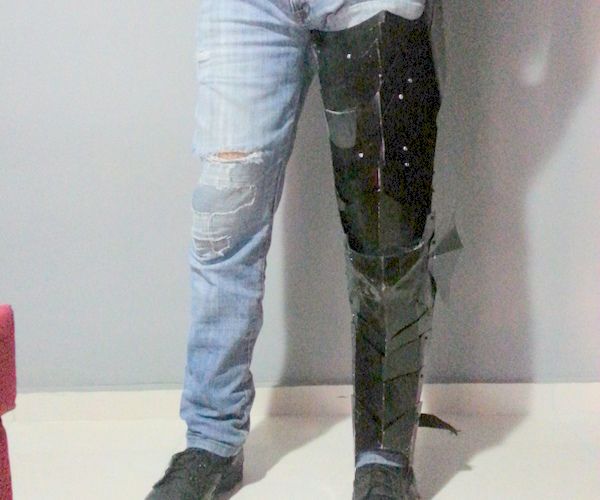

When building Leg-Armor ,gauntlet armor ect , hand made and to your measurements it can be a bit hard , Here I will explain how to make a custom dummy arm for props using easy to find materials , the same Technic can be applied to almost every body part ! The only thing you really need to buy for this is Silicon base Bondo or filler and you can get this in any hardware store for less then 10 Dollars
I used the dummy leg to make this" https://www.instructables.com/id/How-to-Build-Leg-... ", so if you are interested in making leg armor click that link !
