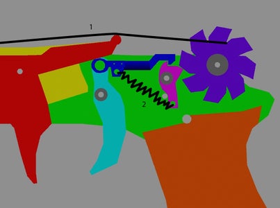

My design is based off of one of Over Boost!?'s design... don't remember which... I'll try to explain it as best as I can...
Ok so... the black line with the 1 is the rubber band. The black line with the 2 next to it is a spring. So... when you pull the trigger, teal, it pulls the blue forward. The spring holds the blue part down while it creates tension with the purple piece. Once the trigger goes up to a certain part the blue part goes up, releasing the purple part. This releases the... what color is that? violet? alright violet part to spin and release the rubber band. To stop the spinning the tension created from the blue and purple causes the purple to shoot back and stop the violet part from spinning anymore. And... repeat.
The rest of the gun I've designed based on different guns. The length and design of the gun was based off of the guns in the movie Equilbirium. The handle I made so that it could fit the Beretta 92 side grip panel.
Well... there's my design, if you want to use my design, go right ahead.

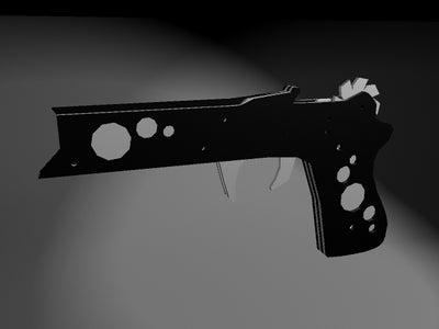

This next step is dependent on the person. If you've figured out the how the mechanism works fully and don't need to visualize how it works in 3D... or... if you know how to make it in Illustrator accurately then you can skip this step and the next, if not then continue reading.
Depending on the different 3D programs available this process could be different. However, the overall idea of it should be the same. The goal is to make the 2D drawing that was made previously and make it into 3D. I first "converted" the 2D design into digital with Adobe Illustrator and used it as a template for the 3D designing.
In your 3D program of choice, make a plane of the outline of the part. Then make a duplicate of the plane part and add thickness to it to match the thickness of the material. This next part is optional, but I like to see how it moves by animating the parts... completely optional. Next select the plane objects and export it to OBJ file format.
