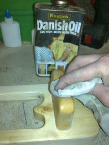

Give the whole thing a good sanding, and then you can fit the shelf with two screws from the back through the pre-drilled countersunk holes and then fit a hanging loop.
Step 12:
Give it one or two coats using the finish you prefer - varnish, wax oil etc - I used Danish oil here, and when dry glue the mirror into place - I use silicone for this as its flexible and makes it easier to replace the mirror in the event of an accident.
You may want to glue felt on the back or some other material, this improves the overall appearance and protects the mirror coating.
