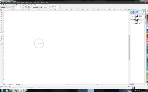

I started with an image I grabbed on the internet for inspiration.

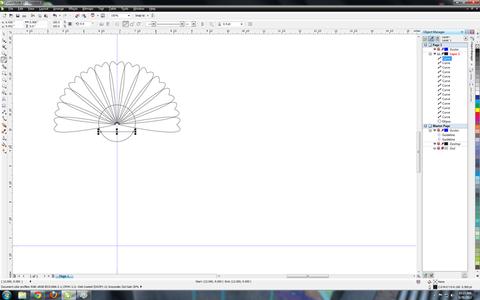

I made a circle as the base for my design. Then I created one unit for the fan design and used copy -> paste -> rotate to fan the units around. I did something similar for the comb teeth: made one tooth, copied and pasted and moved 'em around until I had 5 evenly distributed ones.
