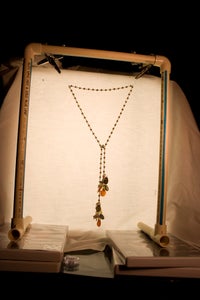

Arranging jewelry for photography can be a real challenge, especially with necklaces. I do a lot of shots for a local jewelry designer, and she wasn't always happy with the limitations of laying the jewelry out flat. We wanted to try hanging some of the jewelry so it would present more naturally, but doing so in a lightweight softbox created challenges of its own. I had recently seen a quick DIY using a wire coathanger and invisible thread, but the coathanger was a bit too flimsy for the larger necklaces, wasn't very stable, and the only option I had was to tie the pieces directly to the coathanger. It photographed extremely well, but the setup involved was too time-consuming. So here is my solution: PVC and alligator clips to the rescue!

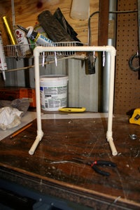

First, measure and cut all the PVC to desired lengths. The hanger will be approximately 14" tall and 11" wide when finished if you go by my dimensions.
PVC dimensions that I used:
Two 12" lengths, two 2" lengths and one 9" length
The reason I only used two small lengths for the "feet" is because I noticed, while shooting, that anything behind can show up, and might be in my way in the photo. Besides, two little feet in the front is still really stable, I promise! You can always add on for your needs.

Now it's time to add the hanging clips to the top section of your PVC. Make sure your wire isn't frayed at the ends, and insert from the bottom to the top. I worked from the inside out so I could look into the PVC and make sure it was lining up correctly. I also looped the wire around the PVC so they would hold until I secured them.
Once they are all in, grab a nut and run the wire through it. Take the wire and loop it back through the nut, holding the nut flush to the PVC and the alligator clip tight so as to not have much extra wire between the clip and the PVC. (A little tiny bit is good, but not much.) Pull the wire tight, trim it down, and smash the ends so they won't poke you.
Step 6: Finishing Up
Lastly, put all the PVC parts together. The great thing about using the framing wire is being able to bend your clips back without stressing the wire too much. Optional: tape off the alligator clips and spray-paint it gray so it functions as a gray card.
To use, cut a length of invisible thread and hang anything you want, using the clips to hold the ends of the thread. When photographed, it will look suspended in midair!
