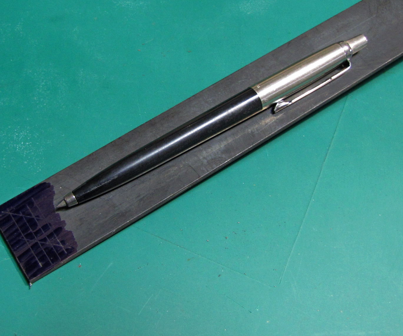

Turn the flesh side up and mark where you want your rivet holes and folding groove to be. I noted the wrong length (300 mm) in the design, in reality it's 260 mm.
Punch the holes and make a groove in the middle.
Use a round object, preferably in metal, to round both ends.
