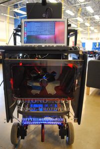

The focus of this type of robot will be a home made differential drive robot with tank steering. You can build your base or find something that already has a platform to build from.
This means find whatever surplus, junk, or piece of metal, wood, or old electronics that you can repurpose maybe even an RC car, automated floor vacuum cleaner, electric wheelchair, etc... Use your imagination.
If you can find a pair of identical motors you can mount them on a board in a parallel fashion and make your own base. My advice on this is to find a source of base that you can find replacement parts for.
I believe you will find the best satisfaction if you can reuse something for your robot to try and be eco-friendly.
