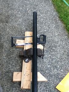

Step 2: Cut Body and Plundger
You should have made marks of were you want things to be.... now go and cut those pieces
Remember, wear eye protection and always cut in a vice if you are using a hand-held saw.
