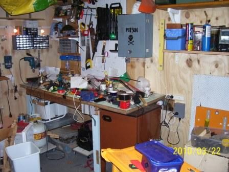

A while ago I got a pool table in my shed, and I wanted to be able to see all the balls, so I put lights above it. I wanted a pull switch on the lights, but when I looked at buying one, they were worth about 50 AUD. More money than I wanted to pay for a switch really. So I built one. It worked well, but was a bit clunky and big. Recently, I put new lights over the table, and decided that it was a good time to improve on my switch. At the same time, I installed lights over my workbench, and I wanted a pull switch there too. So I'm going to show you all three switches.
