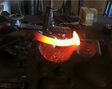

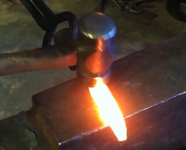

Railroad spike, a special nail widely used in the railway industry, is an important component of rail fastening system. Among the railway system, the railroad spike is usually used to fasten the rail track. Besides fastening, the railroad spike can also be made into some metal artworks such as knife, bottle opener, furniture and so on with reprocessing.
Step 1: Heating the Railroad Spike
Step 2: Forming the Handle
Step 3: Rough Shaping the Blade
Step 4: Drawing Out the Blade
Step 5: Shaping the Blade Outline
Step 6: Forming the Blade Edge
Step 7: Curving the Handle
