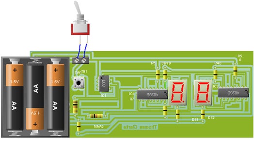

Step 2: Building the PCB
The pictures that I have provided are how I got mine looking make to the smallest I could get them but you can change them if you have double sided PCB I only had single so that why I have 0K resistors to be jumpers. I have put on the schematic what I hope gives a better look on how it was put together and connects put where.

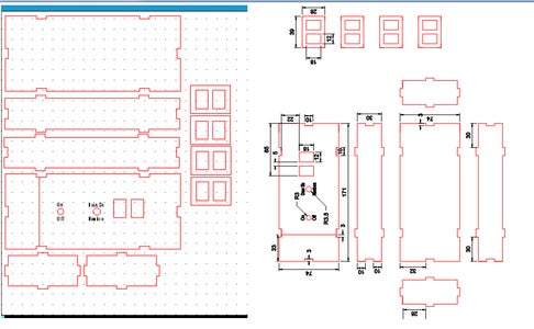

Step 4: Case Design
These are my box size's. My first box I made did not work out due to I changing size every time I used the laser cutter also the ply would was bent. I then chose to use acrylic instead as it was a much better materiel to glue together and cut. The size on the photo is for the acrylic design as it is over all thicker than the ply wood. I cut out rectangles with a line in the middle to create a darker environment when looking at the LED displays. I also engraved text onto the top so people know what buttons are for what as they is to holes on top for a push to make switch to start the device giving out numbers and a on/off switch. That's how I create my number generator it designed it so people would not have to pick numbers my project would do it for them.
