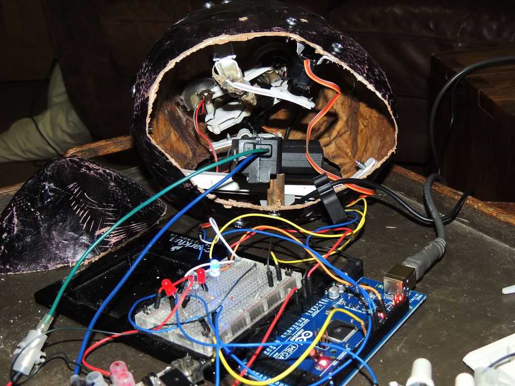

- The physical head, built from papier mache, and moulded plastic (hot glue in fact)
- Input sensors for sight and hearing (using a common webcam with built-in mike)
- servos for controlling eyball and jaw movement
- LEDs for indicating when web data was being received
A connected computer running a programme for
- listening to the web for command data to control the head (using url parsing in a Processing sketch) by communicating over a serial port with an arduino board
- allowing text to be spoken (using a text-to-speech library in the Processing sketch)
- running Skype to allow the head to relay what it can see and hear back to the operator
- sending audio signals to the arduino
An arduino board listening for control data from the mother computer:
- to convert it into output control data for the eyeball servos
- to convert analogue audio signals into control signals for the jaw motor
- to activate separate LEDs to indicate the sources of data (Google RSS and Twitter API)

The Arduino is doing several things:
It is attached to the master computer - digitally via a USB connection and also with analogue input from the audio output of the computer
It maintains a serial port connection with the master computer, over which it is constantly checks for new control digital data that has been sent over the web to the master computer.
This line is Arduino making the serial connection...
Serial.begin(115200);
This line is calling a routine that will check the connection fo rdate...
checkSerial ();
It checks every 10-30 seconds and compares incoming data to the last received action and only acts on it if different.
>>> void checkSerial ()
It checks if there is a connection...
if (Serial.available() > 0) {
Reads the data...
incomingByte = Serial.read();
If the data is 30, it will trigger the Twitter routine (twitterCheck()...
if (incomingByte==30 ) //
twitterCheck();
If the data is between 0 and 25, it's Google data, so call the Google checking function - googleCheck()
if ((incomingByte<=25) && (incomingByte >0) ) // google data is data coded as an integer between 0 and 25
googleCheck();
} else {// No point calling check functions if not serial data received. This is error handling clause
Serial.println("I received nothing ");
}// enf of checkSerial
If new data is received, it will light up indicator warts on its forehead. These are lit by LEDs.
An orange wart lights when Google data (integer between 0 and 25) has been received, the data is used to reposition the servos and the blue wart is deactivated

Eventually all the various parts of the head were put together inside the head...
Looking something like this...
A new bone coloured base coat of paint was applied and the LED-illuminated warts were added...
With some extra texturising colour coats and with a stand added, eventually Twitr_janus was finished.
