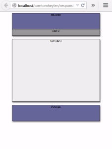

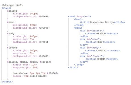

A good way to build your website is by making your HTML tags fluid.
It is very easy to do by using percentage in your css.
For this example we are making a head, menu, the content body and a footer, centered in the web browser.
You only have to give the elements a min-height and a margin-left and margin-right.
With min-height, the elements can increase if needed.
Margin left and right are expressed in percentage to keep proportion for any screen resolution.
And same thing for margin-top and bottom.
You can play around with this figures to fit your needs.

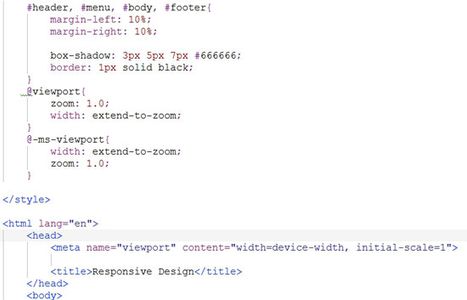

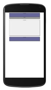

Step 4: Viewport Meta Tag

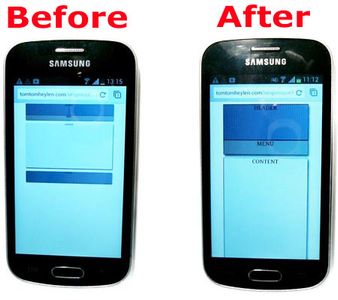

So here we have a responsive website!!!
When I view this website on a mobile device however, it shows the website in full resolution and I have to zoom-in and out to navigate.
Here is where the Viewport Meta Tag comes into play...
The viewport meta tag was Apple's solution to the problem and was quickly adopted by other platforms. But was never pud forward by the W3C.
<meta name="viewport" ... >
Therefore we will define a similar viewport rule in our css.
@viewport{ ... }
And another one as a fix for internet explorer.
@-ms-viewport{ ... }
The width adjusts the site to the device in normal view and landscape view.
And zoom or initial 1 stands for no zooming.
There are a whole bunch of viewport properties to use for every single device.
But to make it easy, we only use a few to fit all.
I leave you a link as a reference.
https://developer.mozilla.org/en/docs/Mozilla/Mobile/Viewport_meta_tag
Step 5: Result
When we view our webpage on a mobile device now, it looks the way we want.
