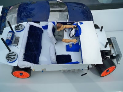

Step 1: Starting the Dash
When doing this part as well as the rest make sure you have plenty of reference pics available.
First thing is to get measurements for the front body posts. Take 2 small strips of styrene and cut/drill holes in them that will allow them to fit snugly over the posts.
Once these are made you measure the inside of the body to find the dimensions for your dash. When you have your measurements sketch them out on styrene and cut them out. be sure to mark and cut any holes for dash vents or the dash cluster as well if you are going to go that detailed.
Now that all your pieces are cut out, use the Bondene in a well ventilated area to glue everything together. Once everything is dry you should now have a basic dash built. Be sure to check and double check that it fits under the body just right. It's always easy to take some material away but very hard to add more in such small amounts.
Once everything seems to fit correctly you mark where the mounting tabs will go for the body posts and glue them to the under side of the dash.

Step 4: Seats/Door Panels and Back Dash
Now take your hard foam and cut out the shape you would like for the seats. Simply put some fabric over it and sew directly through the foam.
For the Door Panels, Measure out how the overall shape needs to be and cut that main shape out in the styrene. Once you have the shape you can sketch the detailing/dividing lines of the doors on it.
When that's done you can either paint them or go one step further and individually cut each piece out and add a bit of fabric to spots.
Make "L" shaped brackets out of styrene by heating/bending small strips and use them to attache the door panes and seats to the base sheet of styrene you're using for the "floor".

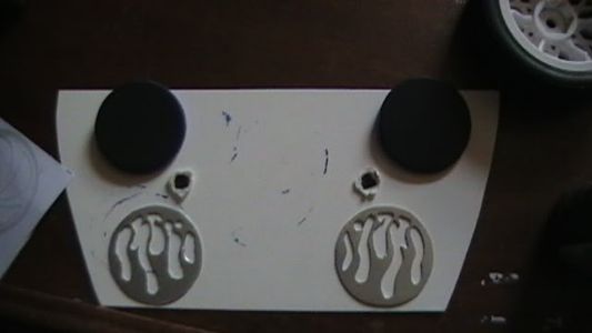

To make the back dash it uses the same steps as the front with the exception of speakers. For the speakers just trace a soda bottle cap on styrene and cut them out and paint. If you want speaker covers trace the cap twice more and draw your design on the inside of that circle. Then very carefully cut out the design.
The NOS bottle is used from the bottom part of the paint ball holder. Just cut it to the length you need and add a small styrene cap to the opened end. Flip the NOS bottle over and add some small circles of styrene that you either cut out or used a hole puncher to get. Glue all the pieces together and then paint. Add a sticker and some small gauge wire for a hose and your done!
On my back dash I wanted to make an Amp. Instead of scratch building one which I could have done I opted for utilizing parts already on the car...The ESC! The heatsink on it made a perfect looking Amp so I simply cut a hole and mounted it to the under side of the dash.
Now that everything is assembled, simply paint to match and your done with those pieces!

Step 7: Finishing Up!
When it's all said and done you can then take the action figure of your likeness and customize them how you see fit to resemble you more if needed. Once done you need to cut them off at the waist and secure them to the bottom plate of the interior.
NOW YOU'RE FINISHED!!!!!
I hope you enjoyed this instructable as much as I did doing the project. This is by far the most detailed build I've done on any of my rc cars and it just gets more and more in depth!
