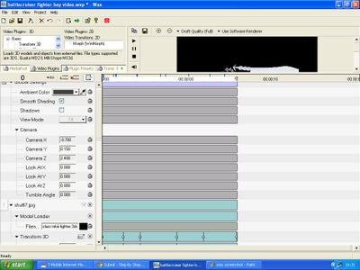

Step 4: Models Into Wax 2.0
The next stage is opening the models in wax 2.0, this is how. choose the add media files icon above thew mediapool in wax. select a picture file .jpg/.bmp/.png in the pop up box, what picture this is does not matter as it will not be visible in the final video. Drag and drop this still into the timeline at the top track, stretch it until it lasts as long as you want
Then switch from media pool to video plugins. select the model loader plugin and drag and drop this onto the image track, click on the model loader plugin which appears and select the 3ds file you created earlier. wax will then prompt you to find all the textures, this is easy and almost automatic( just keep clicking ok) if they are in the same folder as the model. when all textures are found the model will appear in the viewer /preview screen.
After this bring in your background clip in the mediapool  and drop it into a track below your model loaded track. the image/video will appear in the background in the preview area.
Step 5: Keyframes
Now we have the model but as time passes in the video it just stays still, HOW BORING! we can make it move though.
open up the transform 3d plugin that automatically drops in with the model loader and notice that there are a range of fields describing the position, rotation and size of the model. all are currently set to default. to make the object move set the position you want at the start of the motion by typing in the data,  then click the little clock icon on all the quantities you want to change during the motion. then move the time slider along to the time at which you want the motion to stop, type the new values for position, rotation and scale into the transform 3d list and click the clock icon for each one again. then play the video and watch as the object moves between the positions/rotations/scales as time passes. AWESOME! also note that the positon of the camera in 3d space can be set and keyframed using the camera section under global settings, this will move the camera relative to the models but picture/video backgrounds will remain unchanged.
If you add more tracks then remember that the ones at the top obscure the ones below them.

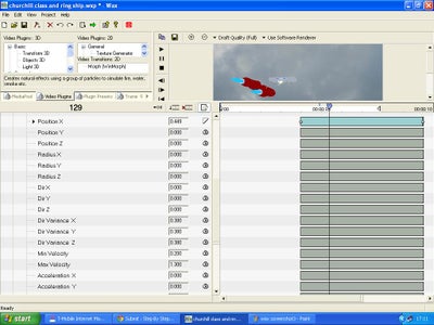

wax also contains the particles plugin which can be used for smoke or explosions, simply drag an image into the tracks and stretch it to start at the point you want then drop in the particles plugin. this is set to a fire effect but by changing the particles settings it can be used in many other ways. the following set ups will produce:
explosion in zero gravity:
