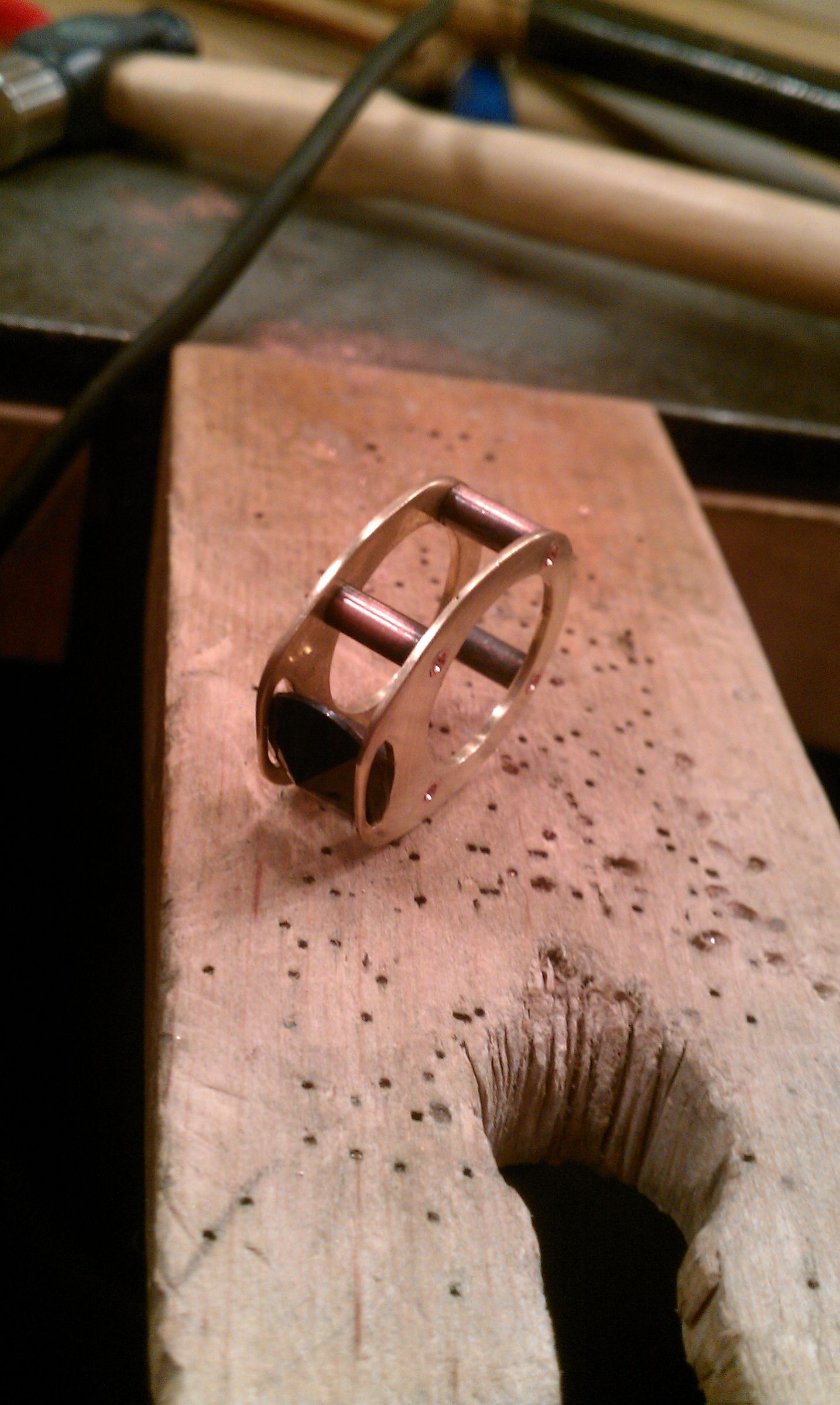

Step 4: Solder the Templates and Form the Top Shape
Place your bound templates on the soldering block, with the rounded part down. This will give you some stability and will allow you to solder it from the insides, which is crucial to clean soldering of pretty much everything. Use hard solder (or medium, if you have only medium and soft solder). You can either cut small pieces with your wire cutter, or hold the solder wire with your tweezers. There is no easy formula for the amount of solder needed for a good seam. Remember, the better your parts are fitting, the less solder you will need. The more solder you add, the more likely that you will have to file that excess after soldering. And that is both tedious, as solder is pretty hard to file, and troublesome, as you may file too much of your base metal and cripple your work.
Another word of advice here: remember that you are using a silver colored alloy to join your pieces. If you are working with copper, the risk of staining metal, beside a clearly visible seam, is quite big. I recommend silver plating any work made of copper alloys. If you don't want to do this, or can't, opt for brass or nickel silver, as the solder won't stand out so much.
Again, if you are using sterling silver, remember to flux all of the surfaces, if you are using other metals, focus on the seams, or the solder won't flow. Heat your pieces evenly until dull red, the annealing temperature, and then focus on your seams. The solder should flow somewhere at that time, if you were using cut pieces. If you are holding solder wire in your tweezers, that is the time to touch the seam with your solder. Heat a seam with the torch from the outside and touch it with solder from the inside. Don't put solder directly in the flame, or it will just for a ball that will be definitely too big for your soldering. The solder will be suck up through the whole seam and any excess should stay on the inside. Don't overheat your pieces while soldering and try not to solder for too long, or the flux will burn out and you will be unable to proceed. Once the solder flows, also don't wait too long, or you will draw the solder to the outside surface and stain your work. Cool your piece on a steel block, don't quench it in water. This will allow slower recrystalization of your metal and will keep the structure from breaking unexpectedly.
After soldering pickle, rinse and dry. If there is any excess of solder, file it now, or it will marr your piece while forming. When it's clean you can shape the top of your signet with a bezel mandrel of your choosing. As the metal is annealed after soldering, you don't need to anneal it again. You can see my signet and the square mandrel on the photo. Tap the signet lightly with your mallet to shape it. If your mandrel is angled, like mine, don't tap on the angles, or you will cut through your work. Just go for the sides and you will do just fine, even if your edges will be slightly rounded.
