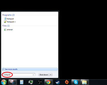

1. Open Notepad
Click the windows button then type "notepad" as in Figure 10
If done right should end up at Figure 11

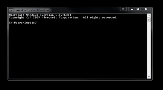

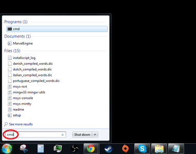

1. Open Command Prompt
Click the windows button then type "cmd" as in Figure 17
If done right should end up at Figure 18

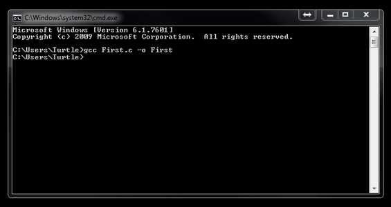

2. Type in the GCC command
gcc First.c -o First
Figure 19

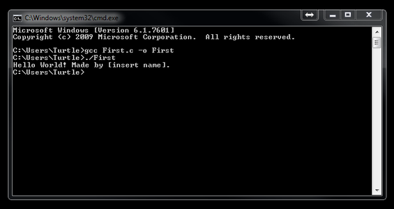

3. Type in the command to run the program
./First
Figure 20
