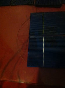

Step 1: Preping the Tabbing Wire
You will want to cut all wire to length with a sharp pair if scissors because the longer the 40 watt or more soldering iron is on and at full heat it will turn black faster which leads to more cleaning.

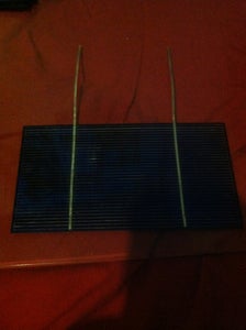

Step 2: Prep the Cells
Use a #186 rosin flux pen which is a must and run down the up and down lines on the front of the solar cell. Next you will solder the end of the wire down to the cell and then run the iron and wire down the front of the cell. When going down the front of the panel you should go at a steady pace and follow the bubble of solder on the wire making sure to stay on the white line of the cells. Do this with all cells
