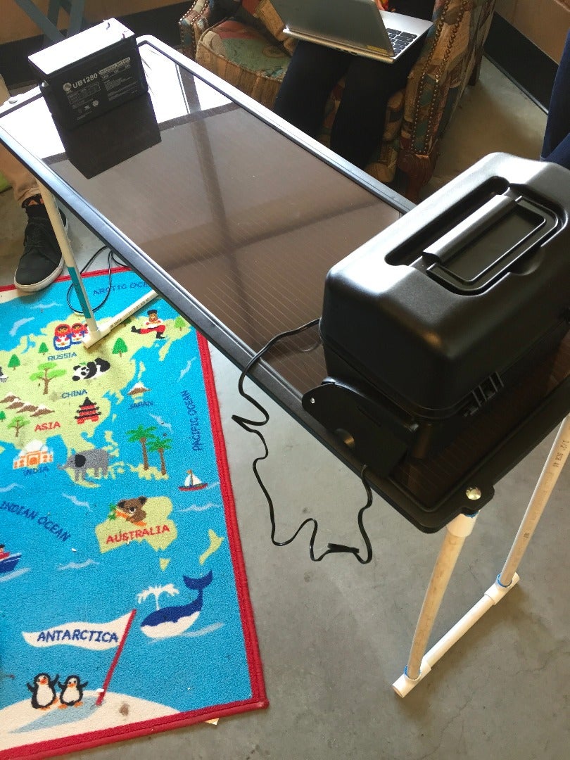

For our table, we chose to use a 12 volt solar panel with an ABS plastic frame for its durability and light weight, and because it came with a battery charger and electrical connections.

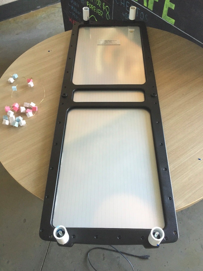

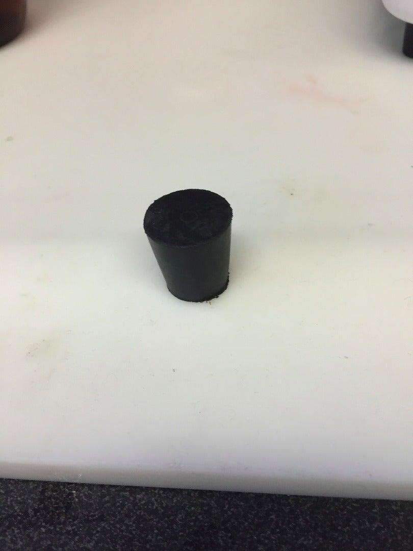

Step 2: Attach Rubber Stoppers to the Mounting Holes

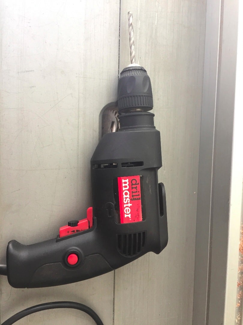

Drill holes through four rubber stoppers and using bolts and nuts, attach them to the four mounting holes on the solar panel.

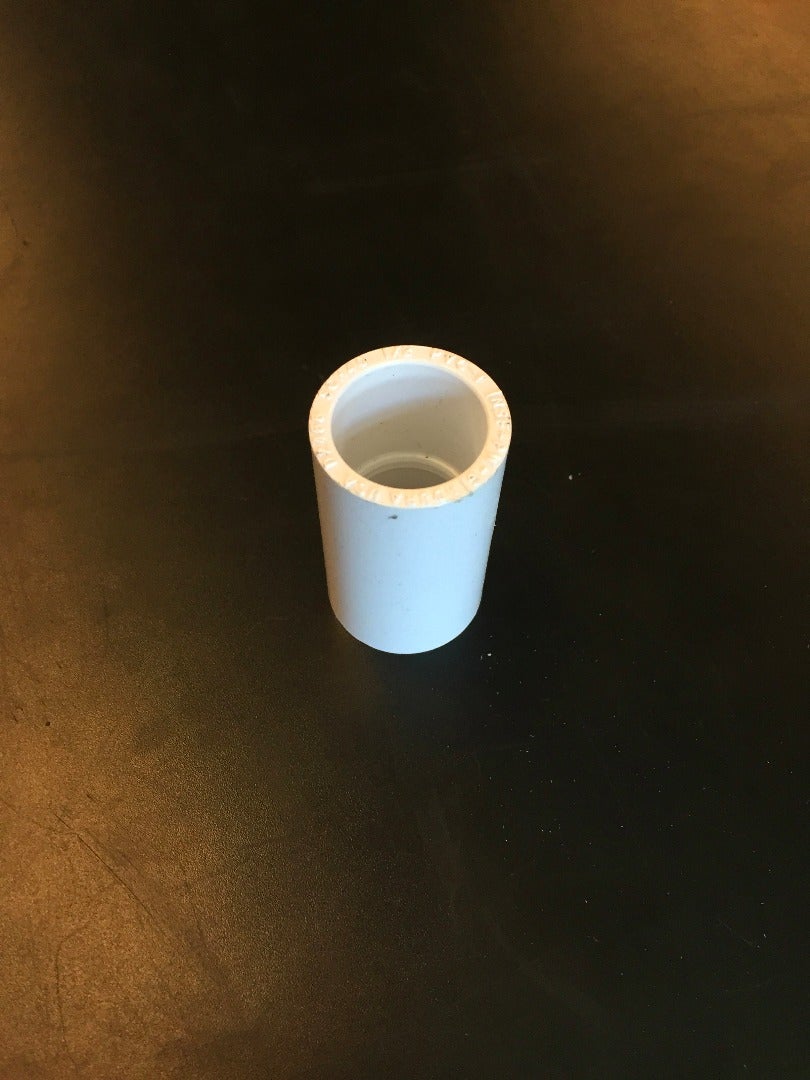

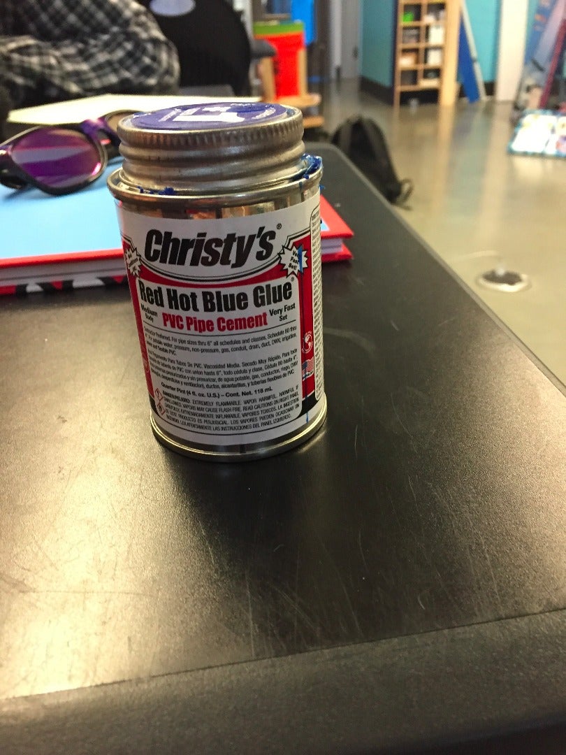

Step 3: Attach PVC Joiners to the Stoppers Using Pvc Cement
Apply PVC glue to the inside of the joint. Using a mallet, beat the joiners onto the rubber stoppers that are already attached to the solar panel.

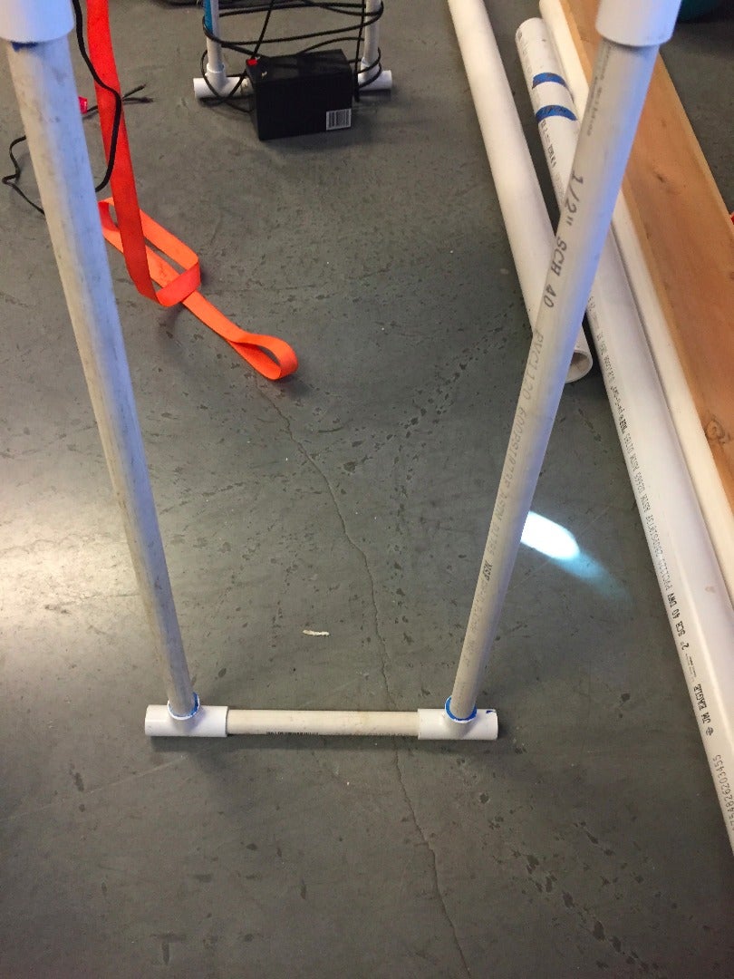

Step 4: Assembling the Legs

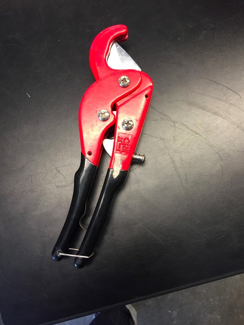

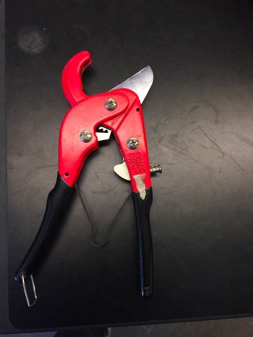

Cut four equal lengths of PVC, the length however tall you want your table to be. Using corner joints and PVC cement, connect two sets of legs together at the bottom, for added stability.

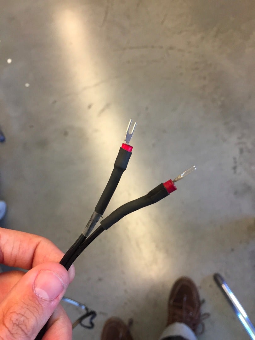

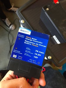

Step 5: Preparing the Electrical System

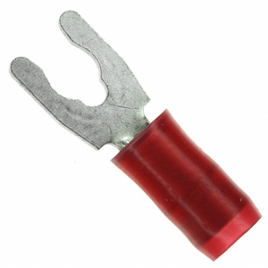

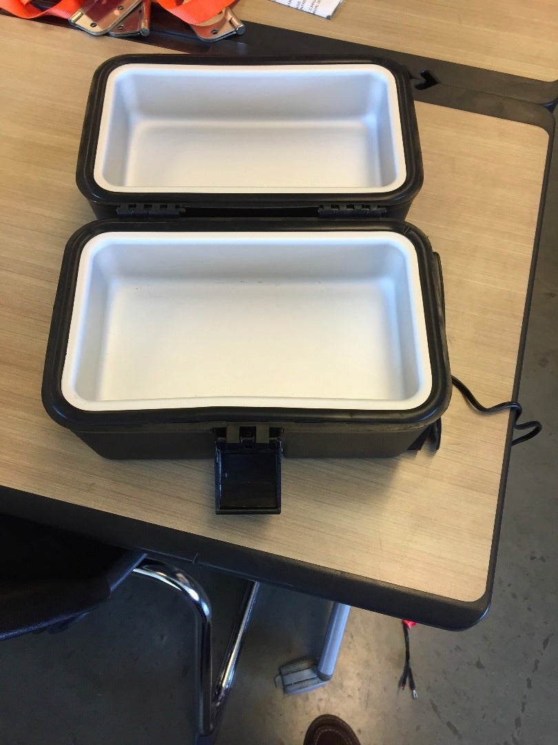

Now that your table is assembled, you can start putting your system together. For our system, we are using a lead-acid battery, but any 12-volt battery will do. We are also using the charge regulator that came with our solar panel, but still, as long as it's compatible with your battery, it will be fine. make sure all of your plugs are compatible. Since our stove was made for use with a car lighter plug, we replaced its plug with a pair of spade connectors. Heat-shrink works perfectly well for connecting them.
