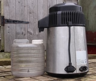

Step 1: Materials
I used:
A pressure-cooker
8mm OD copper tubing
A plastic bucket.
Step 2: Construction
Form a coil with the copper tube, leaving a long lead-in. I wrapped around a demi.
Drill a hole in the bucket, and poke the lower end of your coil through this.
The copper tube is connected to the pressure-cooker with a (brewing) cork
A bit of Blu-Tac seals the tube to the bucket
Fill the bucket with cold water, and maybe some ice.
Step 3: Use
A person might take two bottles of cheap wine. put them in the pressure-cooker an heat them to the boil. The distillate would be enriched in alcohol, collected from the bottom of the still.
One might wish to add a bit of colour with homemade caramel, and have homemade brandy.
And then one might drink the output and try to post a coherent Instructable.
