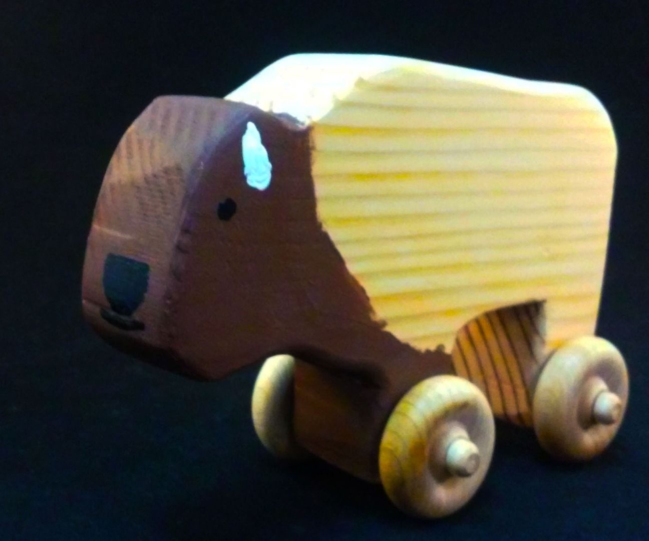

Step 2: Find a Picture
Find a picture of an animal that you wish to make
· Preferably a side view as this will make it easier
Step 3: Print Your Picture
1. Place your selected picture in a program where it can be resized
2. Resize it to the size you want your final toy to be
3. Print it out
4. Trace around the picture and exaggerate the more important features of the animal to make it look more like a cartoon
5. If both legs are visible in the front or the back combine them into one
6. Select where you want the wheels to go, and draw a dot for the axle holes

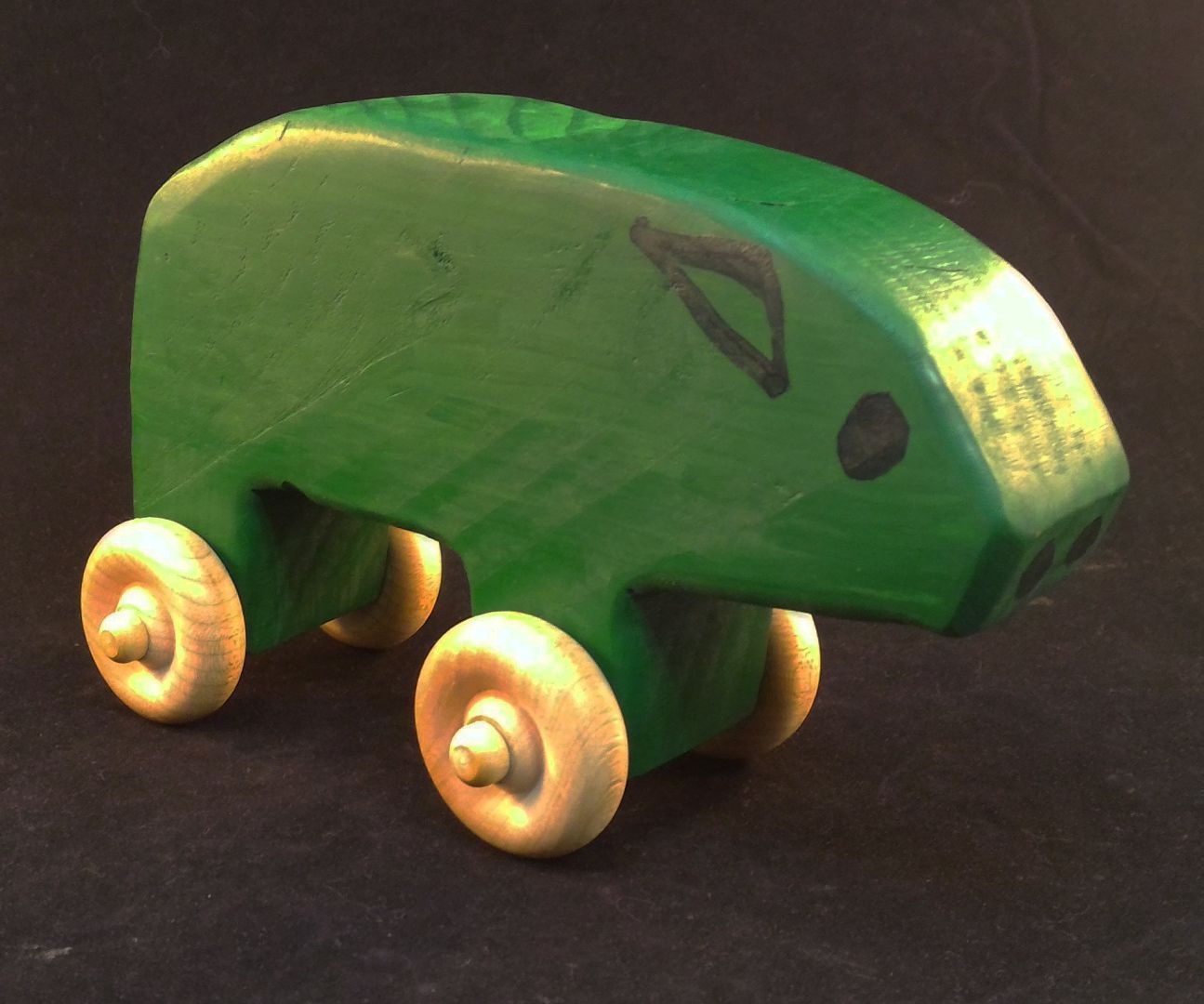

Step 7: Routering the Toy
1. Place the round bit in the router table
2. make sure that the edge of the bit is level, or lower than the edge of the table
3. Test it with a scrap piece of wood, and adjust the bit as necessary
4. Router the edges of your toy
Step 8: Sanding the Toy
1. Use the sander to round out all the edges that the router could not reach
2. Sand out all the imperfections in the toy
Step 9: Painting Your Toy
1. Using a pencil, draw all the details you want your toy to have
2. Paint your toy while using the details you drew as a guide

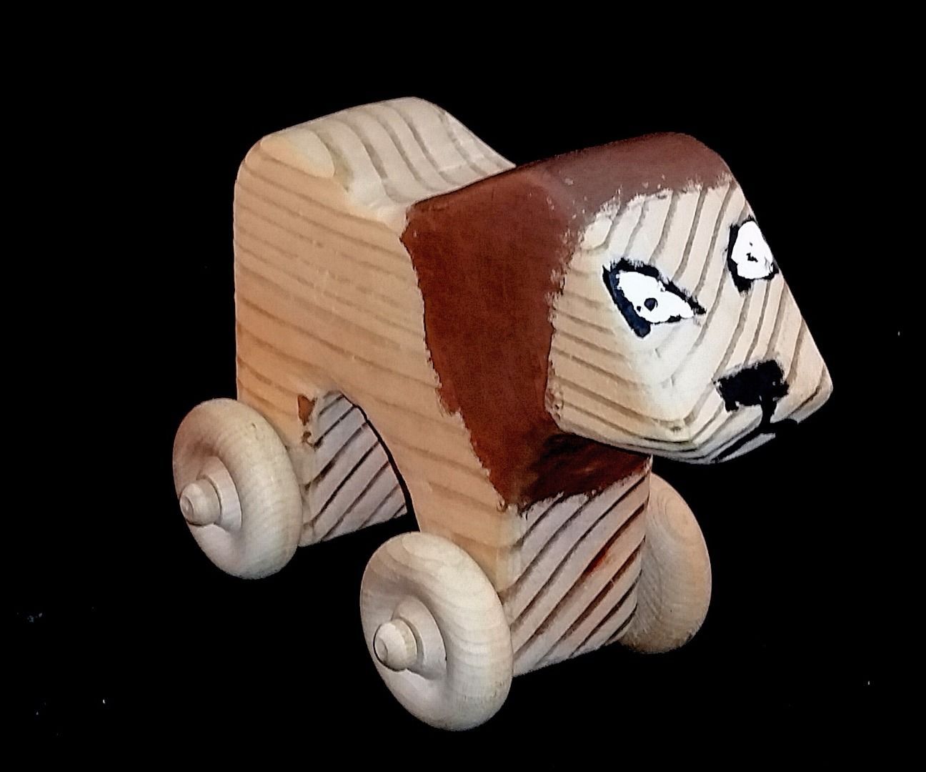

Step 10: Attaching the Wheels
1. Check to make sure the axle still fits in the hole (it’s possible the hole got paint in it and the axle no longer fits)
2. Drill it back out if the axle no longer fits
3. Put a small amount of wood glue in the axle hole
4. Put the axle through the wheel
5. Put the axle, with the wheel on it, into the hole with the glue
6. Leave the axle out far enough for the wheel to spin freely
