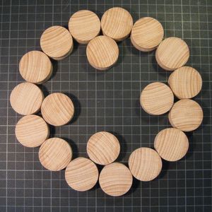

In this tutorial I'm going to show you, how to make a trivet, that can change the shape and be very easily stored.
Being a student space is very valuable in my kitchen. This trivet can be used for pans and pots of different sizes, without needing a huge amount of storage space.

I'm convinced that a picture is worth a thousand words. The image shows the concept of the trivet. Every piece can be turned freely around the neighbouring pieces.
You can of course connect more than one piece to another.

Step 3: Cut the Wooden Disks
I wasn’t able to find wooden disks in the size I needed them (and I don't have a circular saw), so a friend offered to cut them (and I forced him to take photos ;-)). He used spruce, but you should get a hardwood, because it's more durable and softwood tends to get black when it's getting to hot.
