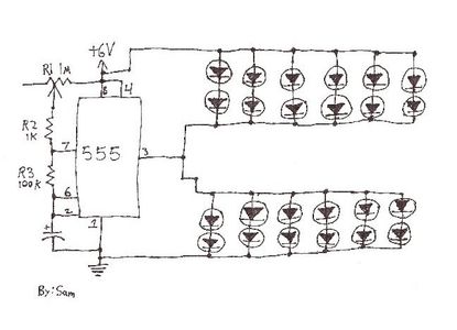

For this step you need the big part of the water bottle, the sharpie, and the needle. First what you do is make dots on the water bottle. Make them even, because it will look better. I found that when using a 2 liter bottle with 24 LEDs, you should make a dot every 2.5 inches across and 1.5 inches down. Then with the needle make two holes on each dot so the LEDs will go on the dots.
Step 4: Soldering the LEDs
For this step you will need the water bottle with the LEDs in it and the soldering iron. First start with the row that is the farthest away from the opening. Take all of the LEDs out except that row. Then solder wires onto the different leads of the LEDs. Use red for positive and black for negative. In case you don't know, the longer lead on the LED should get the positive electricity. After you have finished the first row do the next one, until all of the LEDs have two wires connected to them.
Step 5: The Circuit
