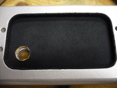

Step 8:
8 ° Detect the distance to the speaker of your phone, bring it on the bottom of the 'central housing and executed a bore of 15 mm. This is necessary to let out the sound. Also practiced the 4 holes of 6 mm for the brackets.

Step 10:
10 ° At this point you have to coat the housing to avoid damaging your precious phone.
Glued to a strip of material thin and soft on the edges. I used imitation chamois taking part to the phone, but you can use other materials.
Step 11:
11 ° Cut the cardboard to adjust the seat depth of the phone to ensure that once entered the phone, it protrudes 1 to 2 mm.
Step 12:
12 ° Coat the bottom with the same sidewall material, glued with vinyl glue.

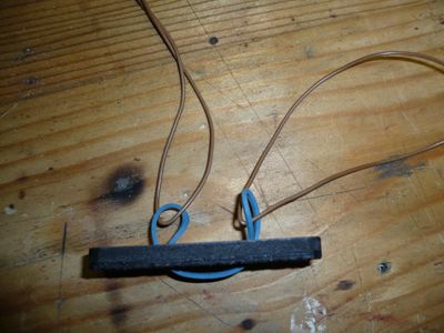

Step 14:
14 ° Mounting brackets: Insert the elastic through the two holes of the bracket, threaded holes in a piece of rope that you insert into the holes of the wheel. Now pull the strings to tighten the strap and stop it by inserting the piece of stick. Now you can pull the rope.
