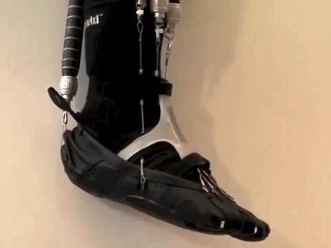

I needed to create some actuators for an animatronics project I'm working on. Air muscles are very powerful actuators that work very similar to a human muscle and have a phenomenal strength to weight ratio- they can exert a pulling force up to 400 times their own weight. They will work when twisted or bent and can work under water. They're also easy and cheap to make!
Air muscles (also known as a McKibben artificial muscle or braided pneumatic actuators) were originally developed by J.L. McKibben in the 1950's as an orthotic appliance for polio patients.
Here's how they work:
The muscle consists of a rubber tube (bladder or core) that is surrounded by a tubular braided fiber mesh sleeve. When the bladder is inflated the mesh expands radially and contracts axially (since the mesh fibers are inextensible), shortening the overall length of the muscle and subsequently producing a pulling force.
Air muscles have performance characteristics very similar to human muscles- the force exerted decreases as the muscle contracts. This is due to the change in the interweave angle of the braided mesh as the muscle contracts- as the mesh expands radially in a scissors like motion it exerts less force due to the weave angle becoming increasingly shallow as the muscle contracts (see the diagram below- figure A shows that the muscle will contract to a greater degree than figure C given an equal increase in bladder pressure).The videos show this effect as well. Air muscles can contract up to 40% of their length, depending on the method and materials of their construction.
